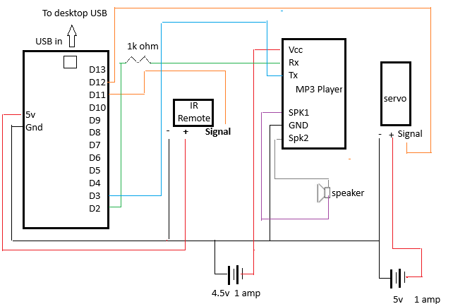

Hi everyone:
My earlier post got kind of out of hand, and branched out into too many paths (sorry). I am posting a new post which specifically addresses my main issue. The earlier post is obsolete.
This project is basically a skeleton that (when an IR Remote is pressed) turns his head, says an MP3 file, and turns his head back. The current version of my sketch is attached. It works perfectly (no complier errors); when button 1 is pressed, the servo turns, and the MP3 plays, and the servo turns back. This happens every time I try it (which is good), until all of a sudden, when button 1 is pressed, the servo turns, and the MP3 only plays and buzzes for a second. I thought I had this fixed, but it still fails once in a while. It will work perfectly maybe a dozen times, and then stop. When it fails, the IR receiver still lights, and the blue light on the MP3 player lights, but the MP3 player just gives a one second buzz and stops. The only way to fix this is to re-load the sketch. The wiring has not changed, the code has not changed. and the board was not moved.
I am using:
Arduino Uno R3
DFRobot DFPlayer Mini
Infrared IR Wireless Remote Control Module HX1838 with a 38 KHZ infrared receiving module
Hitec HS425BB servo
Here is the wiring:
and here is the code:

You haven't followed my advice from the earlier, 'obsolete' post. The return path for the motor current is still routed through the breadboard, which isn't designed to deal with large currents.
Why are you using a breadboard anyway? I see at least 2 components (the player and the IR receiver), that could be plugged into it but for some reason are not, making the breadboard pointless.

To clarify, both the IR receiver and the Mini player are plugged into the breadboard. When I tried to show the actual breadboard connections I was told it was too confusing and folks could not determine how the components were wired, so I drew a schematic type sketch.

If you want to avoid confusing, draw an actual schematic! Hand-drawn is fine, if drawn neatly.
Yes, you should. But you don't want high currents like the motor current to go through the breadboard, so route that back to the power supply ground directly with a separate ground wire. Don't forget that a high current flows from the power supply +V to the motor, and that same current has to flow back to the power supply ground. You don't want that going through the breadboard in either direction.
That points to a servo power problem.
The servo and DFPlayer could draw close to 2Amp peak.
Tell us more about that 5volt supply.
How is the Uno powered.
Leo..

I have been going through all the suggestions I received. Thank you all for the input. I now have a working IR remote and DF player mini. Apparently, the problem was either the breadboard or loose wires (as was suggested). I used a new breadboard and rewired the project with different wires. The IR remote and DF Mini player have now worked repeatedly for two days.
Thank you PaulRB for your suggestions on the servo ground wire. I now have a dedicated ground wire from the servo back to its power supply. The servo is powered by a 5 V 1 amp wall power supply. I checked, and it is putting out 5 volts. It has a Current Draw at Idle of 8 mA, a No Load Operating Current Draw of 150 mA, and a Stall Current Draw of 800 mA. Unfortunately, the servo is still whirring constantly. The whirring stops if I remove the signal wire from the Arduino Uno, so that is what I am working on now. I am using pin 12 for the signal wire, but numerous sources say I don’t have to use a PWM pin (they will be in short supply on the project). The Uno is currently powered with the USB cable from my desktop (is that a problem?). I tried a 100 uf capacitor across the servo’s power leads, but it made no difference.
I will not start new topics on the same subject. I had received comments that my original post was varying from the subject heading, so I thought a new post was what folks wanted. My apologies.
I was asked to draw an actual schematic, instead of the drawings earlier.
This is my current code which works.

If anyone has any ideas on the whirring servo, please let me know.
I think I have addressed all concerns. Believe me, the last thing I want to do is waste the forum's time.
Thank you.
This isn't the problem right now, but don't do this.
When you put a leading zero on a number like that, C takes it to mean that the number is in Octal (base 8). With the value "0001", this doesn't make any difference, but if you put, for example, "0013" that would mean 11 in decimal, not 13. How confused would you have been when the player insists on playing track 11 when you wanted track 13?
It's possible that one of those other libraries is interfering with the Servo library because they are both trying to use the same internal hardware timer on the Uno. This might cause the signal going to the servo to jitter, causing it to whirr.
