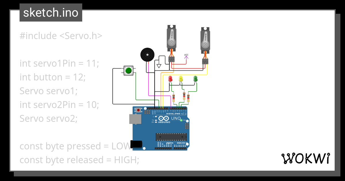

Hello,
Just wondering if the code I wrote had some errors in it or if i should try something else with it. At first I tried to use true and false statements but thought that it would be to complicated for turning 2 servos. I deiced to use for statements instead but i cant test it out the code because I dont have my uno with me and it wont let me verify without it. Im not to confident in my "for" statements I feel like I might have problems with that part.

You should really differentiate the servo pin from the instance. servo1.attach(servo1); does this compile, I would be surprised if it did.
I would imagine you would also want to debounce the button too.
What is the end goal, just to move two servos together?
int servo1 = 11;
Servo servo1;  // duplicate name
int servo2 = 10;
Servo servo2; // duplicate name
You cannot have a variable name and an object with the same name.
for (pos1 = 0; pos1 <= 180; pos += 1)
for (pos1 = 180; pos1 >= 0; pos -= 1)
pos1 for initializer and condition, but pos for increment = error.
 serov1.write(pos1);
serov1 != servo1 Same error in a bunch of places, Copy and pasting errors makes work harder.
serov2, also.
      else if
else if what ???
Code fixed so that it will compile. Will it work the way you want? Dang if I know.

Here is a WOKWI simulation of groundfungu's code
best regards Stefan
Thanks for the link! Ive been playing around with the code and im stuck on how to make it a toggle switch.
