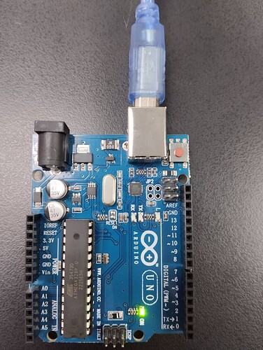

I am a computer science student, current working on my FYP which is i want to develop a IoT project which Arduino and my System. Yes it work in the beginning but after i try connect with multiple RFID reader with arduino UNO board using breedboard without properly setting up (i think so) then this is when the error started coming out after i trying to upload my code program.

What is the TTL-to-USB converter on the board; it's the chipc closest to the USB connector. For original Unos and faithfull clones it will be a 16U2, for other clones it's usually a CH340.

  5. this i not really understand, but i will take a pic of my arduino board. the port it as the devices manager show is port com3.

5: OK, faithfull clone using 16U2
