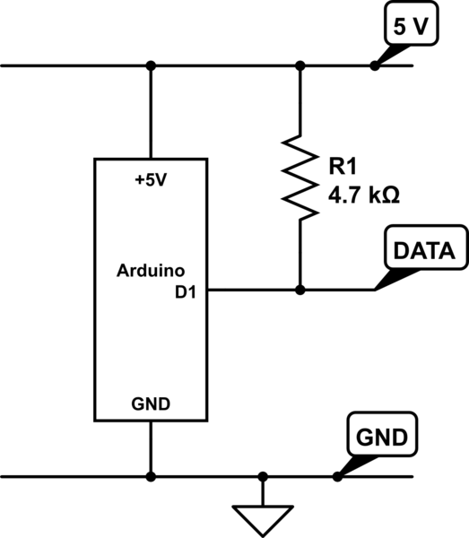

Hi there,
I am trying to read out the serial number from the ds2401 using my arduino UNO. Only i'm not getting any results. I tried searching for answers on the internet but found nothing. I tried the following code i found online.

I connected the ds2401 to my arduino uno this way:
Picture how i connected it. (for some reason the img tags dont work with this type of url)
I hope someone can help me figure this out. :slight_smile:

This reference says you need a pullup resistor on the data wire that's not shown on your diagram.
http://playground.arduino.cc/Learning/OneWire
DS18B20s require 4.7 k ohm pullups.

Thanks a lot guys! got it working now :slight_smile:
DS18B20s reqhure 4.7 k ohm pullups.
To be slightly more pedantic... all 1-wire devices need a communications bus where the signal lines have pullup resistors on them.
