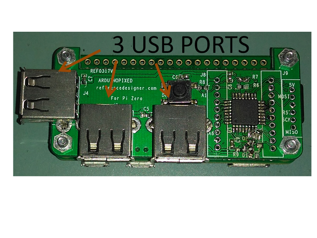

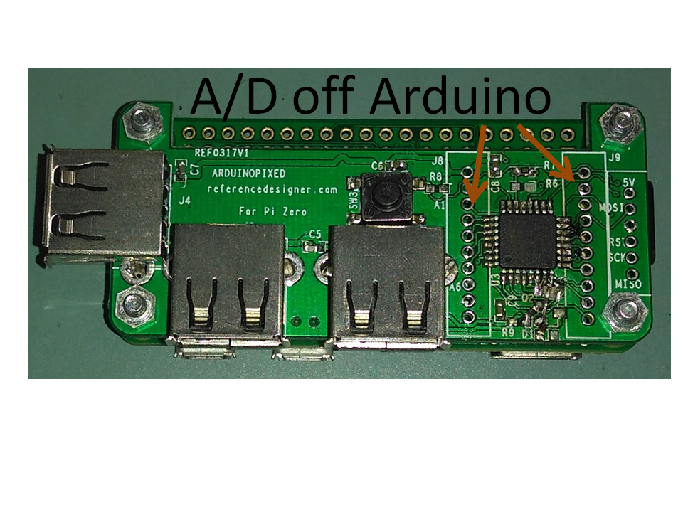

Yes the Built in Wifi and BT is great in Pi Zero- BUT - they DO NOT have A/D. They have USB host but not USB Hub. This is where my ArduinoPixed helps. It uses pogo pins to extend 3 USB Ports and an Arduino.
See pics

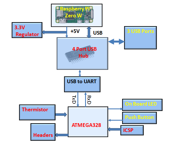

Also the Block Diagram
Thanks for the details of ArduinoPixed and introducing it to me. I pledged my support on kickstarter.
If you use an ATmega32U4 instead of the 328, you won't need a USB to UART interface.
It's got 12 analog pins, 25 IO pins and 2560 bytes of RAM as well as built-in USB.

I checked ATmega32U4 - it is indeed a good suggestion. I checked its price at Digikey and is showing at $4 , which is substantially more than ATMEGA328 but is a great.
The ArduinoPixed was designed for Raspberry Pi Zero, I also wanted to extend USB Ports to it so that a keyboard and muse, for example, could be used.

So what does the USB to UART cost including board space and assembly? Also the 32U4 throughput to the Pi is full speed and can be HID with no hardware mod needed and has 12 analog inputs.
