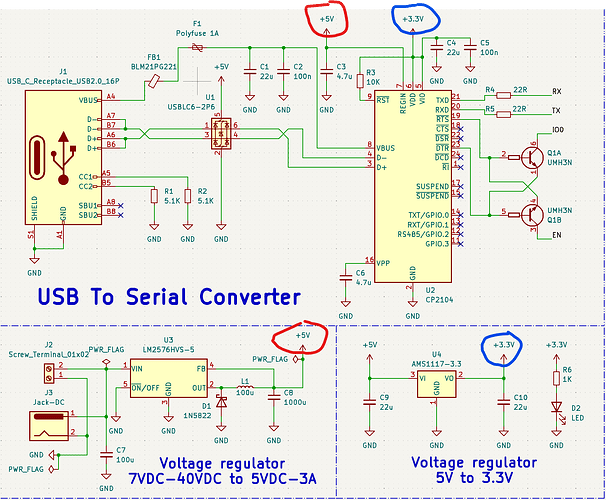

Hi everybody,
I am learning PCB design by myself via the internet, I am using KiCad 8, I am trying to make a dev kit using:
- USB (Type C)
- An external power supply from 7VDC -> 40VDC
- CP2104
- ESP32-WROOM-32E
In the current technical drawing I have not included ESP32 because I still have questions about the power, I have looked at the datasheet of the devices and other people's online tutorials then drew the schematic diagram. My goal is to use the VBUS of Type C to signal to CP2104 that I have plugged in USB, then use the 5V power generated from LM2576HVS to transmit to the REGIN pin to power the CP2104 instead of using the VBUS power like that, is it stable? According to the principle I read that after supplying +5V to REGIN, VDD of CP2104 will supply +3.3V, but AMS1117 is also supplying +3.3V from 5V source of LM2576HVS, so can I combine these two +3.3V sources into the power source of the whole system? Or do I need to isolate them?
