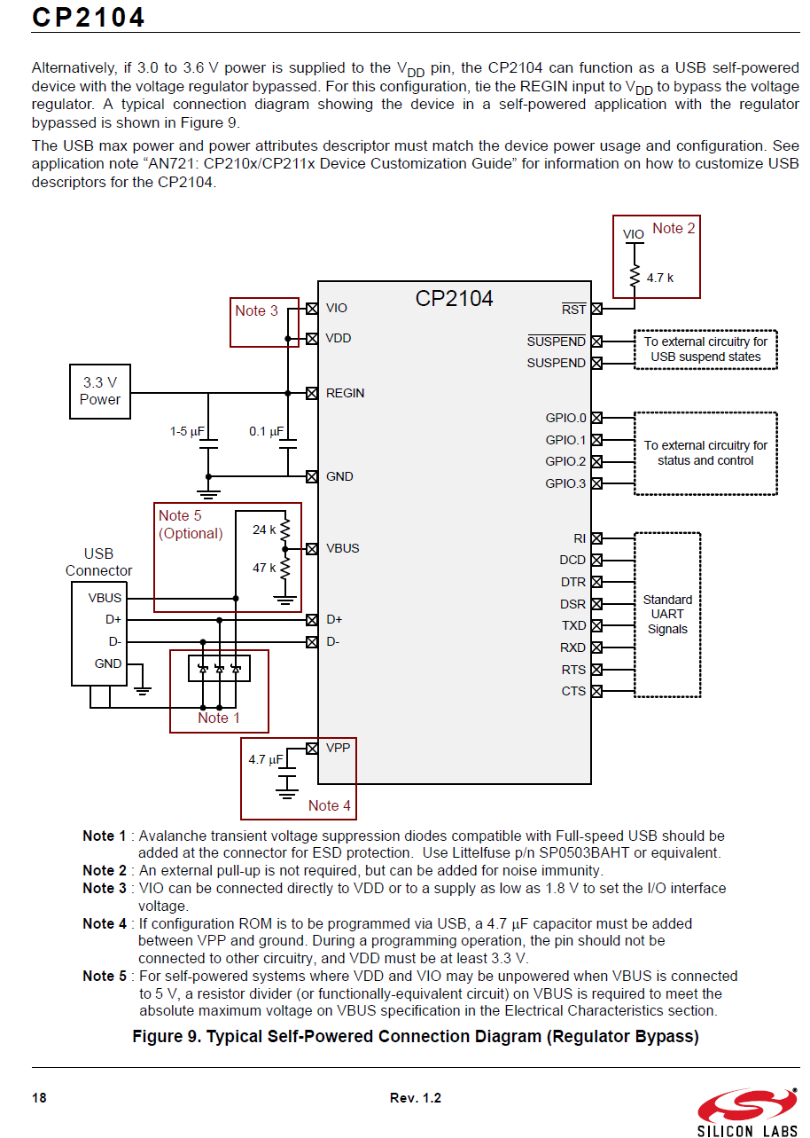

Hey guys,
I have questions regarding the CP2104 module in self-powered mode. As noted in the manual, the REGIN input is connected to the Vdd to bypass the voltage regulator.
  • In contrast to the Bus-powered configuration in which the Vdd output 3.45V with the voltage regulator, I guess the REGIN / Vdd pins are now inputs? Does the REGIN / Vdd really has to be powered with 3.3V even though VBUS already receives 3.3V? I guess yes but just wonder why.
  • After adding the voltage divider (note 5), the VBUS is receiving 3.3V from the USB plug. Just curious, why not also connecting the REGIN after this voltage connector?

Because of the 24k upper resistor in the voltage divider. This would create a voltage drop depending on the current draw of the CP210x, which will be variable.
@ponpon777
VBUS does not supply power to the IC, REGIN supplies the power. VBUS does not receive 3.3V in BUS powered mode, it receives 5V. The USB bus voltage is always 5V never 3.3V. REGIN is connected to 5V and Vdd OUTPUTS 3.3V in BUS powered mode
That would defeat the whole purpose of SELF power mode. Besides REGIN is the power supply pin for the IC. It need to be connected to a 3.3V supply and not through a voltage divider in SELF powered mode

For the confusion, well... D+ goes to D+, GND to GND... and VBUS to VBUS. My confusion is more on which one should I choose: SELF or BUS powered. I guess it depends what my project is. Actually, I just want to use this USB to load the program on the ESP32 and charge the battery if it is connected (using another module). Which one usually people choose?
There you go. Depends on what you want to achieve.
Do you want the device to connect to USB but not draw power from it, then provide power from an additional source to your CP210x. If you want the device to be powered from the bus, then do that. If you want both, depending on what's connected, there are also ways to do that. Depends on the context.
No it is NOT
Bus powered
Understood
Like I said, I just want to use the USB to load my program on my ESP32 (and eventually to charge my battery). Nothing else. Actually, the reason why I asked that is because when I plug my battery after loading the program, I connected the 3.3V from the battery (after the voltage converter MIC5219-3.3YM5 of course) to Vdd and I had huge increase of current consumption (0.02 to 6.8mA). It went back to normal after cutting the trace going to Vdd. I thought it was because of the configuration of the CP2104. I thought to turn off this part of the circuit with a simple slide switch after program is loaded. Probably not the best solution...
Then use the BUS powered configuration. No point in powering the CP2104 if it's not connected to USB, you would be wasting battery power for nothing
Ok, then where should I connect the 3.45V output Vdd? and do I have to? The BUS powered configuration is what I did the first time but maybe my mistake was to connect Vdd output to the 3.3V of the battery. Was it bad?
No, do not connect it to anything other than Vio and the filter capacitors as shown in figure 8 of the data sheet.
When cinfigured as BUS powered, Vdd outputs 3.45V but when the USB connector is removed that voltage is no longer present. If you already have a 3.3V supply I see no real use for the Vdd 3.45V output unless you want to have some circuit powered only when the USB is plugged in.
Well, does the ESP32 need to be powered while I'm loading the program?
Of course but I don't recommend using Vdd, it's limited to 100mA and I wouldn't draw any more than 60mA from it.
Ok, then, I can just connect my battery during the load. And leave the Vdd connected to Vio as you've suggested.
