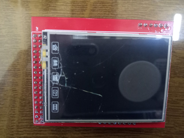

USING MCUFRIND 2.4 TFTLCD ror MEGA2560
I'm trying to run MCUFRIND 2.4 TFTLCD shield For MEGA2560
can not find suitable controller driver
even i can not identify the correct controller for lcd
Xpt2046 is touch controller
any help well be appreciated

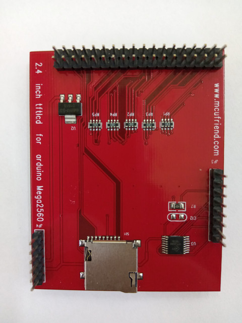

There is no way to read the ID on this MEGA shield.
There is no point in pasting obvious garbage. The LCD_ID sketch only works on readable Shields.
If you own a DMM, check whether RP2, RP4 go to digital #29-37.
If they do, it means: USE_SPECIAL and USE_MEGA_16BIT_SHIELD
Follow instructions in the how_to file for USE_SPECIAL ...
David.

Have you checked the pcb for RP2, RP4 traces ?
If you have tried different IDs, say which IDs you have tried.
It is quite simple. You answer my questions. Then I can give you an an accurate answer.
It takes 10 minutes from your life. But you get an answer in the first reply.
David.

You don't need a multimeter. You can see where most pcb traces go.
If there is no connection, it must be USE_MEGA_8BIT_SHIELD
If the traces do connect, it can be either USE_MEGA_16BIT_SHIELD or USE_MEGA_8BIT_SHIELD
There are a lot of 240x320 controllers. Some need you to enable a SUPPORT_XXX define. e.g SUPPORT_8347D
David.

it works !!!!!!!!!!!!!
g_identifier = 0x9320
thank you !!! you are great !!!!!!
