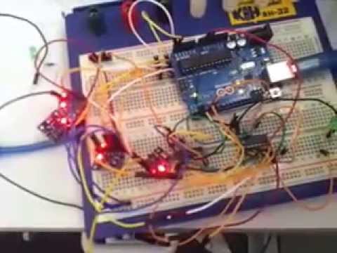

I am currently working on a project that will use 4 GY521s to get data on four moving planes. I had some difficulty getting two of these devices to work. In fact, the documentation stated that I can toggle pin AD0 to to Vcc to get the alternate x69 address, but since my Vcc is 5v I think I fried the AD0 input on that GY521.
I tested with a second GY521, but this time connecting pin AD0 to the Arduino's 3v3 line and I was able to successfully toggle between x68 and x69. I tried the same procedure with the first GY521, but the address does not toggle at all.

Did you consider using a 4052 (or similar) to do some (de)multiplexing of the I2C signals, instead of messing with the address setting ?
This is a I2C multiplexer : TCA9548A I2C Multiplexer : ID 2717 : $6.95 : Adafruit Industries, Unique & fun DIY electronics and kits
Or you could try the other two with SoftwareWire (the SoftwareWire is in the library manager).
Since that youtube movie seems to work to well, changing the address from 0x69 to 0x68 one by one seems to be the most simple solution.
If you have a module with a AD0 that doesn't work, it is probably broken.

What else is on the I2C bus ? More pullups ?
I suggest to remove all the 2k2 from the modules, and have a single 4k7 for the complete I2C bus.

This sure seems like a straightforward method of reading from multiple sensors to me. As has been suggested, you want to make sure you don't have too many pull-up resistors in parallel.
How many sensors do you want to use? If it's less than 8, you could use a 3 to 8 decode chip ($1) to set one pin high (or low, I'm not sure which) at a time. Another option would be use use a '595 shift register (also $1) to set the AD0 line high or low. you could chain '595 chips to control lots of AD0 pins with three I/O pins on the Arduino.

I will be using 4 sensors. I could also use a counter, like the 74LS393, and count modulo 4, enabling each sensor in turn. Since I am looking for simple, I can easily love with hooking up the AD0 pins to the Ardino's IO pins; however, I will need a level converter to make the 5v signal compatible with the AD0's expected 3.3v input.
My concern is the pull up resistance. The resistance goes down a bit for every GY521 that I add and I am not sure what the threshold is. The fellow in the video seems to have solved it. I can't get a good look at the circuit to see whether he added other circuitry to compensate.

An easy way around this on the AD0 lines is to pull the line high to 3.3V and use the Arduino to pull the line low. You wouldn't need to ever set the line high from the Arduino. The I/O pin would be limited to two possible states, an input pulled high to 3.3V and as an output set low to 0V.
