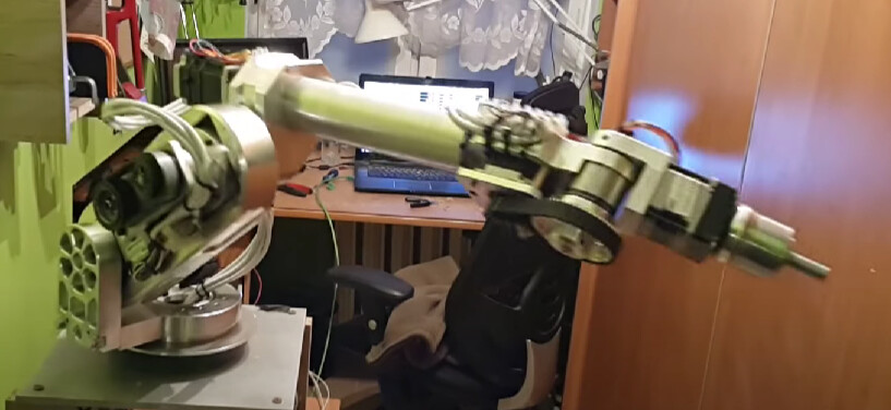

I am trying to build a large robotic arm with Arduino.
For this purpose I want to use several Nema 23 stepper motors.
It seems as if the MA860H Microstep driver module would work for one stepper motor.
Would it be possible to use one driver module for multiple stepper motors and which driver module would be suitable? How much would such robotic arm be able to hold in kg and use in terms of power?
