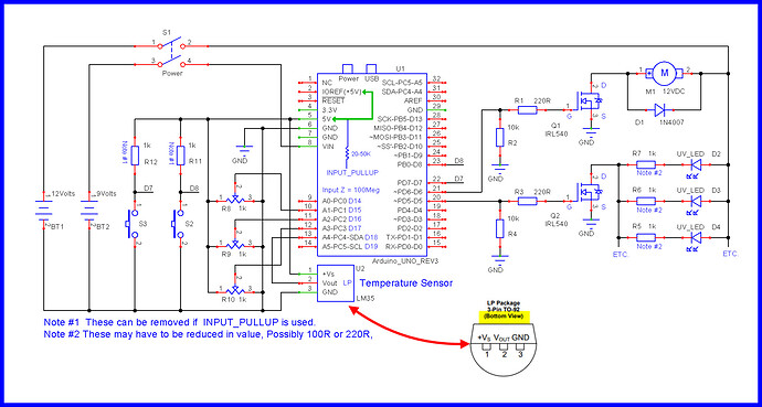

Print the following schematic out on paper.
Can you follow what is happening?
Is there anything you need explained?

I printed it and have studied it, and things are starting to make sense now, I feel I have a loose grasp of this schematic which is of the instructable I am trying to build :wink:

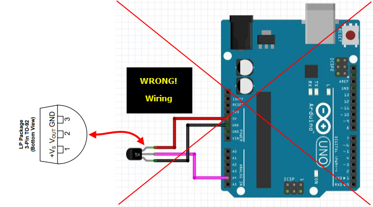

However I wired the LM35 to the way your picture suggested and it got red hot to the touch, so I put it back the way the original says to wire it and it works fine.
Your schematic appears to show the pull-up resistors between the switch and the +5v, however I have these resistors and the D7 & D8 leads on the opposite side of the switches S2 & S3 in your drawing on GND and they work as intended now.
Is this wrong or not?
“However I wired the LM35 to the way your picture suggested and it got red hot to the touch, so I put it back the way the original says to wire it and it works fine.”
What is written on your temperature sensor?
Do you have a link to where you bought the temperature sensor?
If you are using the LM35 sensor, the pinout is as I said and as seen in the image below.
The resistors are supposed to be pull-ups i.e. +5v——[1k]——pin ——[N.O. switch]——GND

If you followed the wiring diagram on the instruct-able web site (shudder) then you need to wire the resistors as pull-ups.
One lead if your switch is to go to GND, the other lead is to go to the pin and resistor, see image.
This is as I depicted in the schematic.
The resistors are supposed to be pull-ups i.e. +5v----[1k]----pin ----[N.O. switch]----GND
Also, you must be mistaken about how the Temperature sensor was wired when it got hot.
The footprint as I showed is correct for the device you linked.
Also, see the image of the physical device shown in my last post.

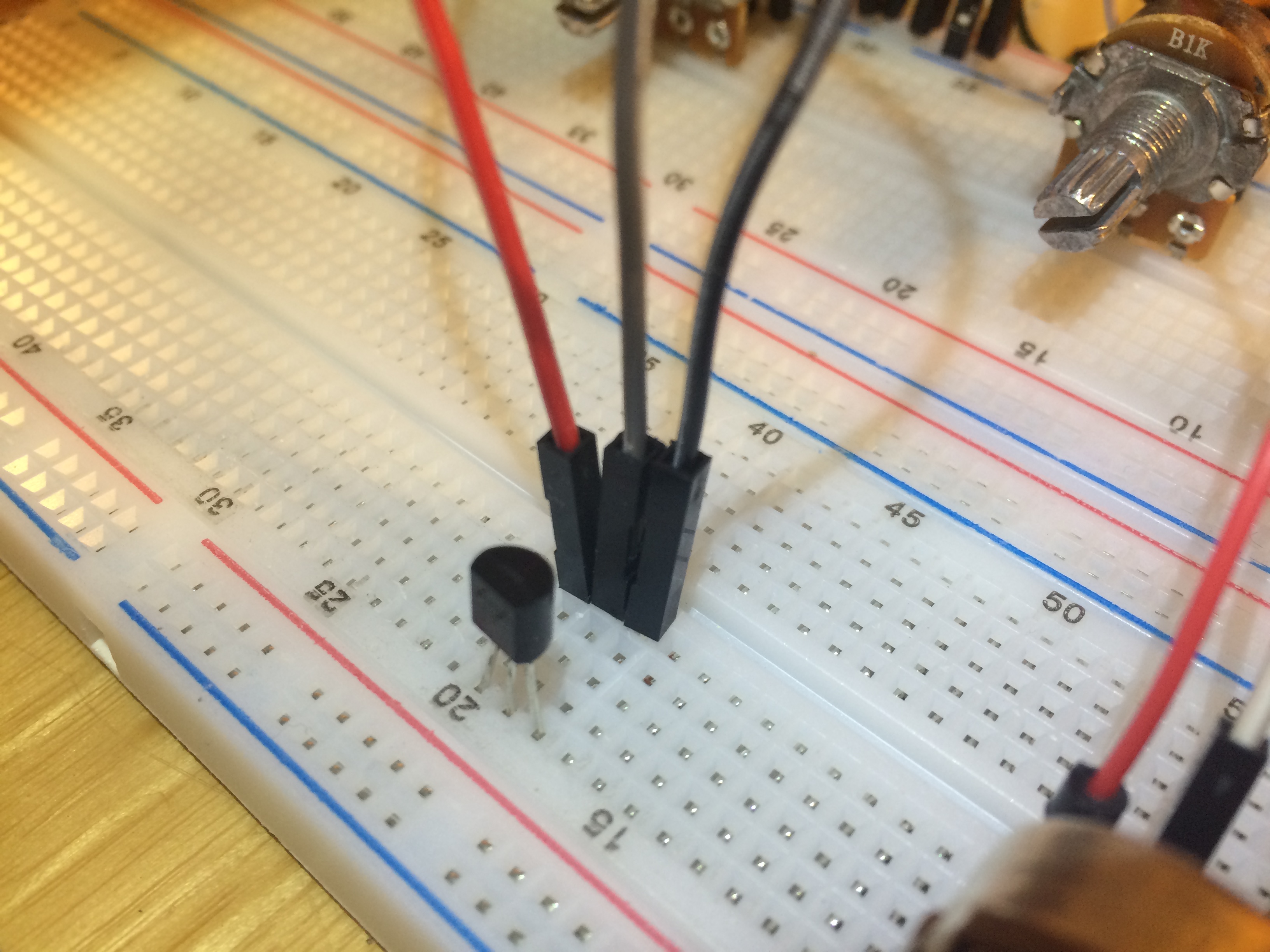

Let’s see a good image of how you have the LM35 wired.
I have the resistors on the black wire, same as the diagram but reversed onto the black wire.
The “proper” way doesn’t work.
Here is the temp sensor pic too.
In the image below, if the red wire is +5v, the black wire is GND and the brown (middle) wire is going to A4 then you are wired as per the footprint I said for you to wire it.
The Instructable image is backward to the image below and is not correct!
In the ‘sketch’ you previously linked, the switches are being monitored for a HIGH (1) when pushed.
The author is an asshole as he has them wired for a LOW (0) when pushed.
I will update the schematic so it matches the sketch and attach it to the next post.
