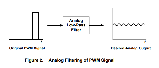

I would start with something like this 16 PWM output board
The other 4 you need could likely be outputted from the arduino itself. I would start with 20 LEDs and prove your concept before moving to the actual pumps.
BTW I've not used this board.
I believe there are other similar devices. I'm sure others in the forum can help you with any board detail questions you might have.
@JohnRob
Is a PWM output what is required here ? I thought that the requirement was a variable voltage output
Oops, I missed a step in my previous post.
To use this PWM output you would have to RC filter the output.
  1. If your pump electronics is sensitive to input voltage ripple you will have to add a substantial RC to smooth out the PWM pulses. And making response slower.
  2. If you pump doesn't mind ripple, the RC can be smaller and the response faster.
This assumes you pump varies flow with input voltage, which your project depends on.
To be clear: PWM is not possible, I tried and it just starts at a certain point at full speed.
I need variable voltage control. So i was thinking digital potentiometers but i need them to be able to handle 12volts..
Oh i see! I did not read your second post;)
The RC filter might work..
I would probably need a nice beefy electrolytic capacitor then!
I might get away with some ripple though..

Not to be obstinate but what frequency PWM did you use and did you filter the PWM?
You need a (voltage) programmable buck converter.
