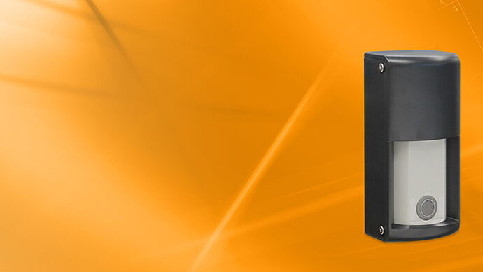

Third: There are other sensors I've found like this one:
I want to know what is the kind of sensor they're using in the product ? It has a good feature to detect cars and not people.

"ProAccess is a high-performance sensor for vehicle detection combining microwave and ultrasonic technology. "
Can I find a similar one on Aliexpress or Amazon ?
