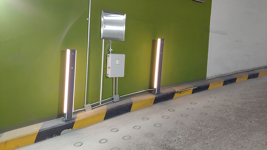

I'm working on selecting parts for a project to count cars in parking areas.
The project parts for now:
  1. STM32 or ESP32 controller
  2. P10 led panels with required power supply
  3. Suitable sensors for the project
I think this method is a good one:
But I don't know what kind of sensors to use.
I want to know if there are other better sensors in the market ? what kind or method to choose ?
More information about the project:
  1. For main parking entrance/exitance gate
  2. Asphalt street type
  3. Count entering/exiting students' cars
  4. Use led P10 panel information sign to inform students about the available parking slots; like this one:

do the above pictures represent your actual project or just something you found that uses sensors to detect cars? Are your sensors just counting cars or are they part of something else such as a gate opener. You need to give far more detail. Like will the cars be stationary at a gate or moving. Are you counting in and out or are you counting for each space. Will there be pedestrians to account for? What number of cars are you counting, how fast will they be going, what surfaces do you have to mount the sensors, is it indoor or outdoor, etc etc.
If it is just the above picture then there is plenty of off the shelf solutions. Google is your friend. ultrasonic/beam break etc could work

If cars have one way in and a different way out it is easy. You need 2 sensors for each to detect in/out. These should be positioned far enough apart that both sensors will be blocked by a car but are unlikely to get blocked by, for example, a person. The sensors can be either an ultrasonic distance sensor or a beam break sensor (the later either requires a reflector or the beam/sensor to be on opposite sides of the road). In your code if both sensors are activated at the same time you can assume a car has passed. You may have problems with trailers being counted as a second car. You might need to code some delay between sensing 1 car and another to prevent this.
If cars use the same entrance and exit then you need to detect in your code which sensor was activated first and second to determine the direction of travel but also to only count if both sensors were active at the same time

I found this image:
What you think of this method ? I think it's using electromagnetic signals like the ones in some traffic light systems to detect the car existence and give it green light priority instead of waiting if the other traffic sides are empty.
But I think this one is a bit difficult because we have to put holes in the asphalt. Using ultrasonic sensors should work the same and easier to install.
