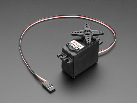

Thanks for all of this help. The vex motor actually moved. It does two spins to the right and then does two spins to the left which I believe is correct. However in my project, the motor has a gear with a belt on it. This belt has a wood rod sticking out. The program is started with a button which moves the belt down until the rod hits a limit switch. The motor switches directions making the belt with the rod go up. It then stops when it hits another limit switch. I'm not sure if this design will work with the servos since they are position based. I was thinking that I could program it to spins a certain amount of times before it switches directions since it would be going the same distance every time. I'm not sure if this is possible or the best approach.
Here are some pics of my mockup
Position based servos can only turn 90 to maximum 270 degree. which is a 3/4 rotation.
If your servo can rotate one full rotation or multiple rotations it is
not
position based.
non continious = position based servos:
  servo.write(90);: turn to middle-position and hold middle-position
  servo.write(0);: turn to   0 degree position and hold 0-degree position
servo.write(180);: turn to 180 degree-position and hold 180 degree-position
continous rotation servo = rotates on and on and on and on
 servo.write(90); : STOP rotation
 servo.write( 0);:full speed for clockwise rotation
 servo.write( 180);: degrees full speed for counter-clockwise rotation
 servo.write( 10); degrees: slow clockwise rotation
 servo.write( 100); degrees slow counterclockwise rotation

So the vex motor is a continuous servo
OK, so…
...some number near 90 should keep it from moving, or make it move slowly.
Try just feeding one number to the servo and see what value makes it move slowest. 90 +/-.
As @StefanL38 has explained more than one time I think, larger numbers will make it go one way, the larger the faster, and so forth.

So I did some testing and it looks like the motor does not move at 0,90, and, 180. It starts moving properly at 55
OK, so what do you get with, say 110? And 70?
Please try to see that tinkering with this can be dignified by calling it experimentation.
Design and perform some experiments. Make guesses (hypotheses) and test your growing understanding of what is in front of you.
Dare to be wrong. When wrong things happen, adjust your understanding and allow that to inform the design for new experiments.
If you aren't too clumsy, there's little danger of damaging much.
It's waht passes for fun for some of us.
a7
So it seems like for clockwise rotation 50-60 is the sweet spot for the fastest rpm. 120-130 seems like the spot with the best rpm for counter clockwise.
