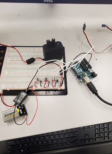

Vex motor code help need
Here is my new code. Since I think its keeps reading buttonState as high I tried to declare it as LOW when button 2 is pressed but that didn't seem to do anything

How are the buttons connected to the arduino uno?
The most important thing in debugging code is to make visible what is going on the code
The easiest to use tool for this is printing to the serial monitor.
Here is exactly your code. But with added serial printing to the serial monitor.
For the printing macros are used.
Macros are some kind of a "type on the keyboard" right before starting to compile.
open the serial monitor
adjust baudrate to 115200
activate timestamp
upload code to the arduino uno
then post the result you get in the serial monitor

Here is a pic of the wiring if that's what you are asking about
So when I start the program it seems fine. Buttonstate changes to 1 when I press it. Then when I press 2 it for some reason messes up. From the data I collect it it looks like the first button is the issue. Even when I hold the second button down , the first button seems to fluctuate randomly between 1 and 0. I'm not sure why this is happening. It seems to always want to be high which make it keep spin clockwise. When I press the second button it does change for a bit and but then button 1 goes back to being high and fluctuating randomly.

I forgot to label it but the rectangle at the top with the two lines coming out is the 9v battery

This indicates that the physical / electrical connections between the wires and the components of your setup are not reliable or that pulling-down is not working at all.
The wire comming from the IO-pin acts as an antenna that catches up electromagnetic noise which is present everywhere. And this electromagnetic noise is enough energy to make the IO-pin change randomly from LOW = 0 to HIGH = 1
This is the reason why you need the pull-down-resistor
You can read about this in this tutorial
how to connect button / switches to work reliably
Do you have a digital multimeter?
If you don't have a digital multimeter you really really should invest $20 to buy one.
If you tell me the country you live in I can lookup some online-shops to re-commend a digitalmutlimeter.
If you have a digital multimeter you should check conductance of the wiring.
possible reasons why this happens:
  • the pins of these tiny push-buttons are too short for a reliable connection to the breadboard
  • you plugged in the push-button so that closing the contact is not between left/right but instead between lower-side / upper-side

So, you're trying to drive a servo with a 9V battery?
Yes. It powers everything except the Arduino
A quick search for 9v battery and servos might be a good idea.
Here's one result:
Here is another that might look familiar:
I looked on the vex website and it says that the 393 motor draws somewhere between 20mA to 1.5A which is a pretty big range. I think it can handle (v but that seems to be on the high side of its voltage capability.
So i just change a few of the buttons again and it now seems to work properly. I'm not sure if it will continue to work or why that fixed it but it seems fine for now. I'm now gonna try to make vex limit switches work with my code Here is the code I used

Sorry for the unprecise information. The only things I changed were the start button which makes the motor spin counter clockwise and the stop button. That seemed to fix the issue. I am currently replacing the button that switches the direction the motor spins and the stop button with vex limit switches. I tried to just plug them in but that didn't work which makes sense. I'm not sure if I have to modify my code or wire them differently.
I also need to use a transmitter since the start button will be separate from the rest of the electronics. I did a bit of research and found that I could get either a 315mHz or 433mHz transmitter. I'm not too sure which one would be the best option or if it matters at all.

Here is a picture of my current wiring
Here is a link to the limit switches I'm using
If you need anymore information just let me know I and I will try my best to provide it for you.

the code in post # 101 prints to the serial monitor each time one of the buttons is pressed
what do you see in the serial monitor if you push the limit switch?
Do you see that the value changes by pushing/releasing the limit-switch
