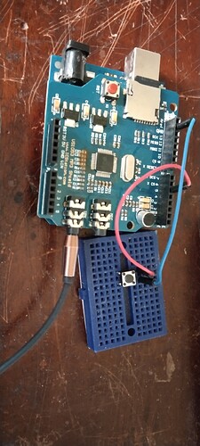

Hello, I'm new to this forum. I want to record audio using Arduino. For that, I'm using VS1053 with the Ogg recording option. I tried with adafruit vs1053 library examples. But recorded sounds were glitching sounds not audio. I copied the v44k1q05.img to the sd card also. I checked the wiring. it can play mp3 files. I'm facing a problem with recording. Please can someone help me?`
