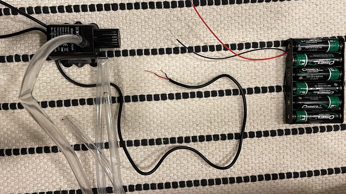

The water pump is not working properly according to the code
It should stop when the soil moisture reaches a specific number but it’s not stopping!
Please help the due date is on Sunday
How do you expect anyone to help when you only show some pictures?
What do you need more?
Start by reading this: How to get the best out of this forum - Using Arduino / Installation & Troubleshooting - Arduino Forum
Your relay appears to be connected to nothing.
Please post a schematic, even if you have to hand draw it.
Also please post your code.

This looks like the same project that @noor803 is working on - are you paired up for this project and if so, why post separate threads?
You need to take this down to each individual item.
Get each one working by itself, then integrate them.
You are pulling a lot of power through the board and it will not take it.
Relays and pumps should be powered independently of the board with a shared ground for signals.
Your relay need to be switched by the Arduino and the pump needs to be connected to the power through the other end of the relay.
All the other components are working fine except for the pump and relay
I tried to follow what you said and connected the relay and pump independently to batteries and here is how it went
The pump is working consistently it’s still not following the code
Excuse my questions i’m a beginner
you might consider how the wires are connected to the relay. It looks like the pump power is running through the NC part of the relay. NC, normally closed, would be a reason why the thing does not do like you want and runs all the time. Try using the NO part of the relay, normally open. Then post a new pic of your connection.

Once you get the pump working you'll find that water still flows from the tank to the plant. You'll want to solve the siphon issue. I used an electrical valve to stop the siphon.

Here is the new one with a pump connected to to the normally open part, but now the pump is not even working

In the picture posted the wires are not connected to the relay module, why?
Two wires from the motor. Right?
One motor wire goes to GROUND, RIGHT?
One wire, power, goes from the motor to the center pin of the relay output. The power to the motor goes to the NO pin of the relay. When the relay is energized the NO pin goes closed. Power is then sent to the motor through the now closed contact of the relay.
