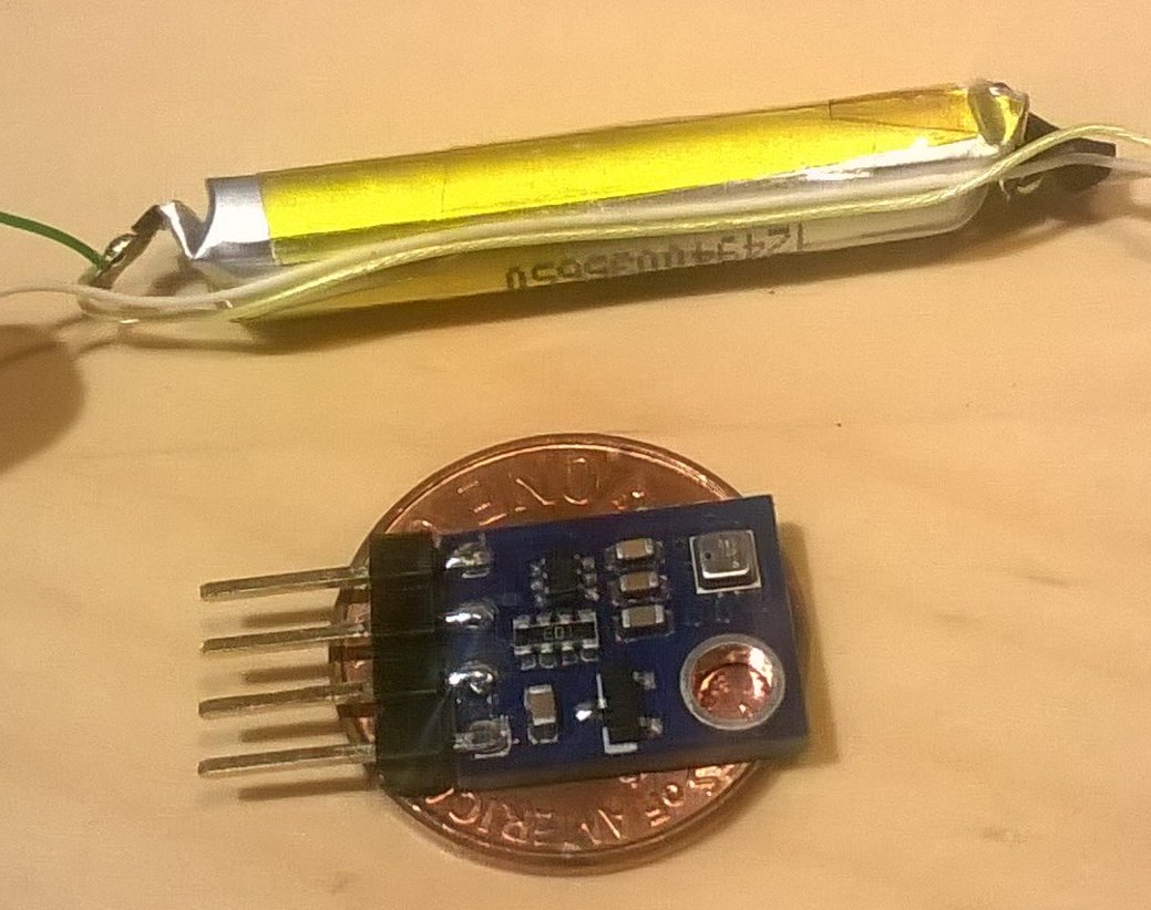

the BME280 is an I2C chip. uses 3.3 volts. that means 2 pins on any Micro.
the ATTINY, 8 pin has 2 pins that you can use with the Ic2 to get the readings.
that leaves a couple pins for whatever else you want to use.
here is a battery from an electronic cigarette and my BME280.
that is a penny it is sitting on.
since it has an absolute pressure sensor, it is measuring atmospheric pressure. the higher the altitude, the lower the pressure. so you would see it relatively stable for the couple minutes it takes you to get things set and open the flood gates. once you launch, the pressure would drop rapidly then you have plenty of time to look at the last 100 readings, pick the point of launch, then just add some value to your reading and as the unit descended, you could fire your solenoid or whatever to release your chute.

either of these would work. the MPL3115A2 seems to be designed for use as an altimeter.
the BME280 can be used in a gamepad and allow you to move up and down to have your player move on the screen.
since either can see fractions of a meter, and I would assume you want your chute to open at more than 30 meters above the ground, you would be safe with either.
and, as you can see, your battery will be the heaviest thing, and even that can be of gossamer design. probably more for your servo than anything else.
