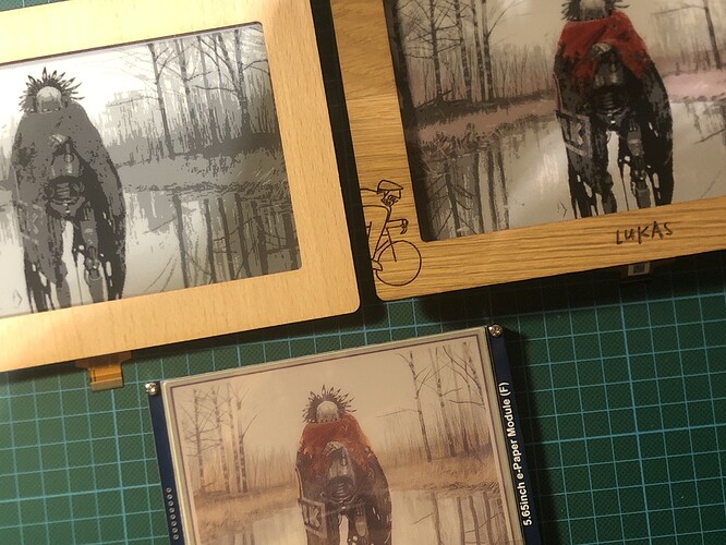

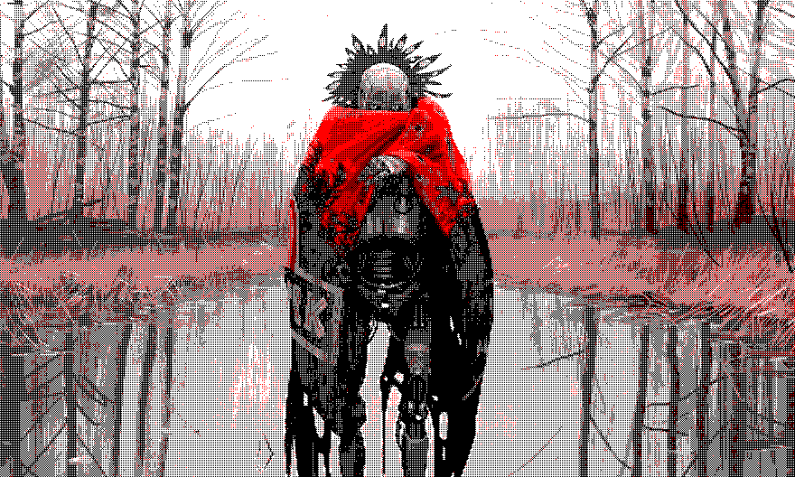

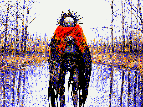

Original
7-Color
3-Color
E-Paper (Sorry it is a very bad photo, my camera on the phone is broken)
PS: Thanks Jean Marc for pushing the new version! 8)
Thanks, and yes I see what you mean, it does look washed out compared to the 3-colour one.
But interestingly it looks similar to the monochrome version, in terms of contrast.
No, i can say contrast is definitely better on the monochrome.
