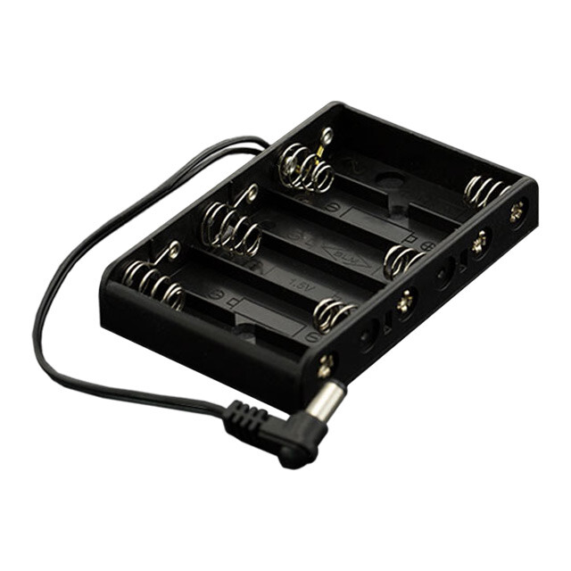

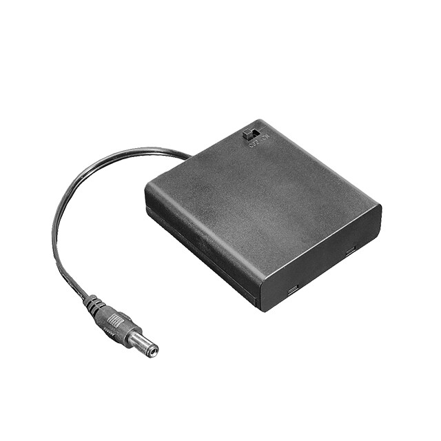

Great thank you. I just saw this on digikey:
the first image is a 6 pack battery holder but the second one is a 4 pack. The voltages would be above 5 anyways for either one but the second one has a custom mounting style(first is chassis) and it also has a cover with an on/off switch. Is it fine to get the 4 pack, despite less batteries? The device won't be running for a long time and is just for short term entertainment purposes.
Unfortunately, no. The Arduino has a built in regulator that needs a MINIMUM of 6V, but preferably more like 7. Your 4 batteries will meet that 6V requirement briefly, when absolutely fresh.
Ah right, so after a while the batteries will just become insufficient?
Would x4 3.6V batteries be overkill? should I just stick to the x6 1.5V
Yes, and the worst part of that is it will likely make your Arduino erratic. If it just shut down that might be okay, but it's more likely to restart, hiccup, etc.
Okay, and yeah i just remembered the 7-12V input to the arduino :sweat_smile:, great thank you for the help! I think that's all I needed to know at this point :slight_smile:
