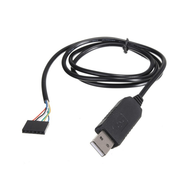

The PL2302
Details:

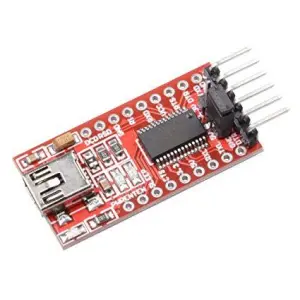

The Two FT232RLs
Number 1:
Details:
Number 2:
Details:
  • This FTDI board is based on FTDI original chip FT232RL.
  • Pins: 6 pin headers and 18 through-hole connectors. DTR, RX, TX, VCC, CTS, GND and PWR, TEN, SLEEP, CTS, 3.3V, 5V, RXL, TXL, GND x 2, TXD, DTR, RTS, VCC, RXD, R1, RSD, DCD (all marked)
  • The internal clock (6MHz, 12MHz, 24MHz and 48MHz) can be brought out of the device and used to drive a microcontroller or external logic.
  • It has a 3.3/5V DC jumper and will supply 500mA through its Vc pin.
  • On the other side, the FTDI USB to TTL serial converter module has breakout pins (Tx, Rx, Vc and GND) that is connected to a microcontroller’s corresponding pins.
  • The module has a mini-B USB port which is used to connect to an USB port of an interfaced device (e.g. a PC).
Sorry if this is too much but I wanted to include everything, thank you for reading this :grinning:
FT232RL 5v or 3.3v FTDI
The ones without the DTR pin are no good for program uploads on Pro-Minis, unless you want to manually press the reset button at the right time.

so the red FTDI one is the one you reccomend right @buckfast_beekeeper ?
I'd go with the last one. You can't really go wrong with FTDI based adapters. I've had mixed success with others that involved lots of driver variants.

+1 on the red FTDI module. I'm a bit confused on the CP2102 module because that chip is a 3.3V device, which means its TX and DTR pins would be 3.3V outputs. I think. But the FTDI jumper controls the voltage of all outputs. I think that's the one to use (set to 5V) for your 5V Pro Mini. It's the one I use with Pro Minis, 3.3V and 5V, and it works fine.

As was already mentioned earlier in the thread, you should be careful to purchase a module that breaks out the "DTR" or "RTS" pin, which allows the module to provide the signal that activates the bootloader on Arduino boards at the right time during the upload process. If you get a module without one of those pins broken out, you will need to manually reset the Arduino board at just the right time during each upload, which is quite inconvenient.
The module you are considering does not break out one of these pins:
so I would recommend against purchasing it. It is worth paying a little extra to get the tool with full capabilities.
I also recommend you get one which uses the standard "FTDI header" pinout:
  • DTR or RTS
  • RX
  • TX
  • VCC
  • CTS
  • GND
That will allow you to plug the adapter right in to an Arduino Pro Mini, or many other boards that use this standard pinout. If you get an adapter with a non-standard pinout, you would need to use a mess of jumper wires to adapt it to the standard pinout.
