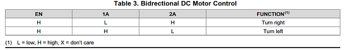

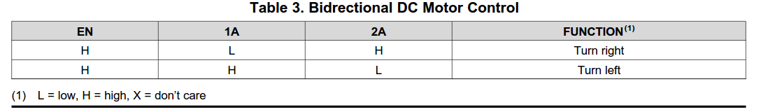

The positive polarity will be whatever you wrote last to it, so either the motor will rotate or not
From the datasheet:
