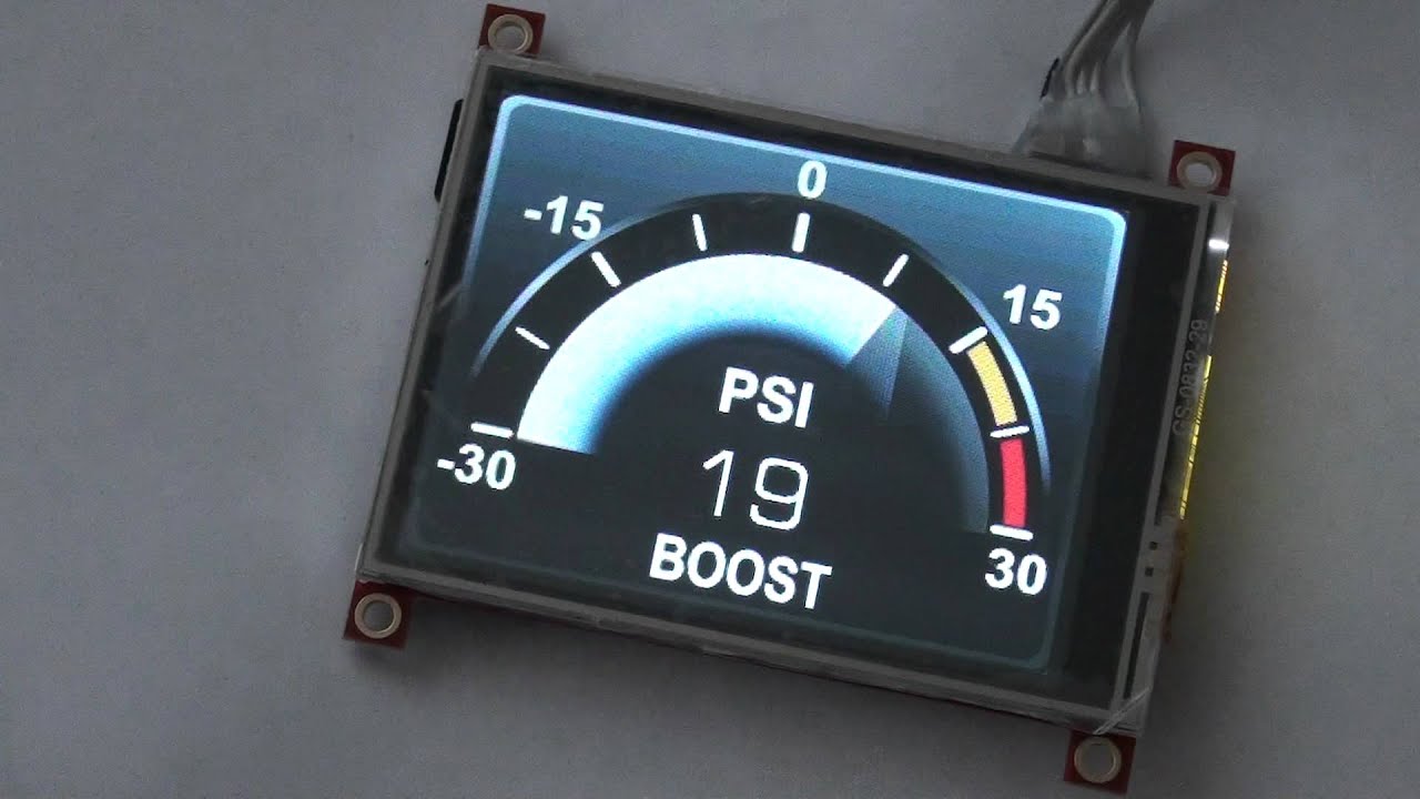

What's the best way (fastest refresh) to make an analogue gauge display?
I've seen some code for a simple circle with tick marks and thin needle. I want something a bit more high-tech looking. I'm more concerned with the bezel and needle shape.
Will overlaying the needle over a gauge image work?
Or just use the bezel from this one and make arduino produce the tick marks
Or will something like this be faster?
Function: tft.drawArc
Lib: ILI9341_due
Video
Hardware: arduino Due, TFT ILI9341 2.2, 2.4" or 2.8"

You did not say what are you going to use to drive the LCD (Arduino Due?). If you do not have something really fast (like RaspPI) then I think you can only make it fast enough if the area under the needle is in a solid color (at any needle position, so something like [this](http://desktopwalls.net/wp-content/uploads/2014/12/Funny Animal Speed Gauge Desktop Wallpaper-900x506.jpg)). So you can draw your bitmap that has the numbers and ticks at the beginning once and then constantly just redraw the needle in a loop like this: draw needle, draw needle in background color (will erase it), draw needle, draw needle in background color, etc...
The gauge on the last picture you have can be made fast (enough) as well (if you don't use gradients). This is something similar. The point is that the background under the needle/gauge is a solid color so you can erase things fast.
Speed is the key.

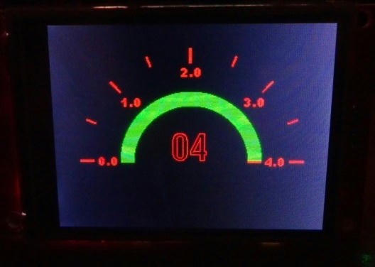

Oops forgot. Using a mega2560 and 3.2 480x320 (still waiting for the display to arrive)

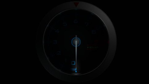

Would this type (3 small gauges including the changing colors) be too much for a mega2560?
The Dial (marks and numbers) it´s posible, but the needle it´s more complicated

http://www.shutterstock.com/video/clip-923287-stock-footage-tachometer-isolated-on-black-hd-loop-fps-d-p.html?src=rel/1188496:2/3p
In my option, it will be slow. If you look at most "arduino tft" videos on youtube, you'll see how "fast" it can draw lines, clear screen, etc. The fastest I've seen on Mega is this. The guy rewrote some routines in assembler to make it fast. You'd obviously have to use his UTFT modified library and a display with SSD1289 controller.
Other than that, you'd probably need to switch from AVR (Uno, Mega,...) to the likes of ARM (Teensy, Due,..). If you go that route, make sure there is a library that can drive the TFT fast enough (if you don't want to write your own).
TFTLCDCyg:
Can the bar be drawn with the body in background color (black) and just the end in some visible color (red) ? Not sure if its just my screen because on the first pic it looks like the body is green with a faint light blue at the end.
Are the tick marks drawn, a font/symbol, or a picture? Which would be fastest?
I think your solution would be the most ideal in my setup.
