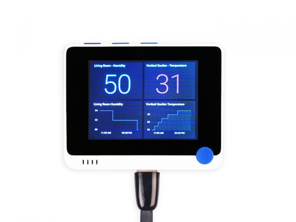

I recently acquired a Seeedstudio Wio terminal that is powered by an Atmel SAMD51 processor. It's pretty sweet with integrated LCD and buttons etc, 192KB ram and a whopping 4MB flash:

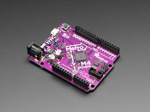

So I was wondering about the history of SAMD51 on the Arduino platform. I looked around and found adafruit metro m4 features the same processor, 192KB ram but 512KB flash:

AFAIK, It was Adafruit that jumped on the SAMD51 chips, probably due to their python needs. It would be neat if the "Grand Central" was taken up by Arduino as a replacement for the Due (which is getting ... stale.)
Adafruit USED to be more tightly associated with Arduino - during the cc/org fight, they were an official Arduino manufacturer in the US, and Adafruit did the Arduino Micro design. I don't know what happened to that partnership (I don't think I want to know!)
Arduino.org did several relatively overpowered boards that never quite saw the light of day (Tian, Otto Lei); the "winning" Arduino folk seem more focused on smaller, less expensive boards. And the software, which has had a LOT of significant improvements since those days, especially WRT third-party hardware support.
I see. Thanks. That makes sense with Adafruit and their CircuitPython. I wonder why not with ESP32, more resources than SAMD51, correct? Maybe ESP32 was later, which also has had Arduino IDE support for a few years.
Adafruit does ESP boards too, but there are assorted advantages to a SAMD51; the peripherals are not as "IoT-centric."

@liuzengqiang As westfw says, I believe Adafruit's goal was to create a board with a microcontroller powerful enough to easily run CircuitPython.
Since the SAMD51 and SAMD21 have similiar (and in some cases identical) peripherals, it meant that Adafruit could leverage the existing Arduino Zero core code and their SAMD21 UF2 bootloader implementation, to achieve both Arduino and CircuitPython compatibility.
The result is set of powerful general purpose boards (Itsy Bitsy M4, Feather M4, Metro M4 and Grand Central M4). The SAMD51's 120MHz ARM Cortex M4F processor, larger memory and enhanced peripherals out performing the SAMD21 in almost every department. It's also possible to run FreeRTOS on the SAMD51 as well. Adafruit have also recently introduced their SAME51 Feather board with CAN bus.
It seems that Arduino.cc have decided to stick with the SAMD21 on their MKR boards and offer various wireless communication interfaces instead. To be honest, the SAMD21 is still a very capable microcontroller and will meet the needs of most maker projects.
Thanks! I'm pretty interested in the wio terminal platform due to the usb host/device support with a display and buttons. I guess I have both Arduino LLC and Adafruit to thank for their software contributions. Seeed seems to be a beneficiary of such software foundation besides Sparkfun.
