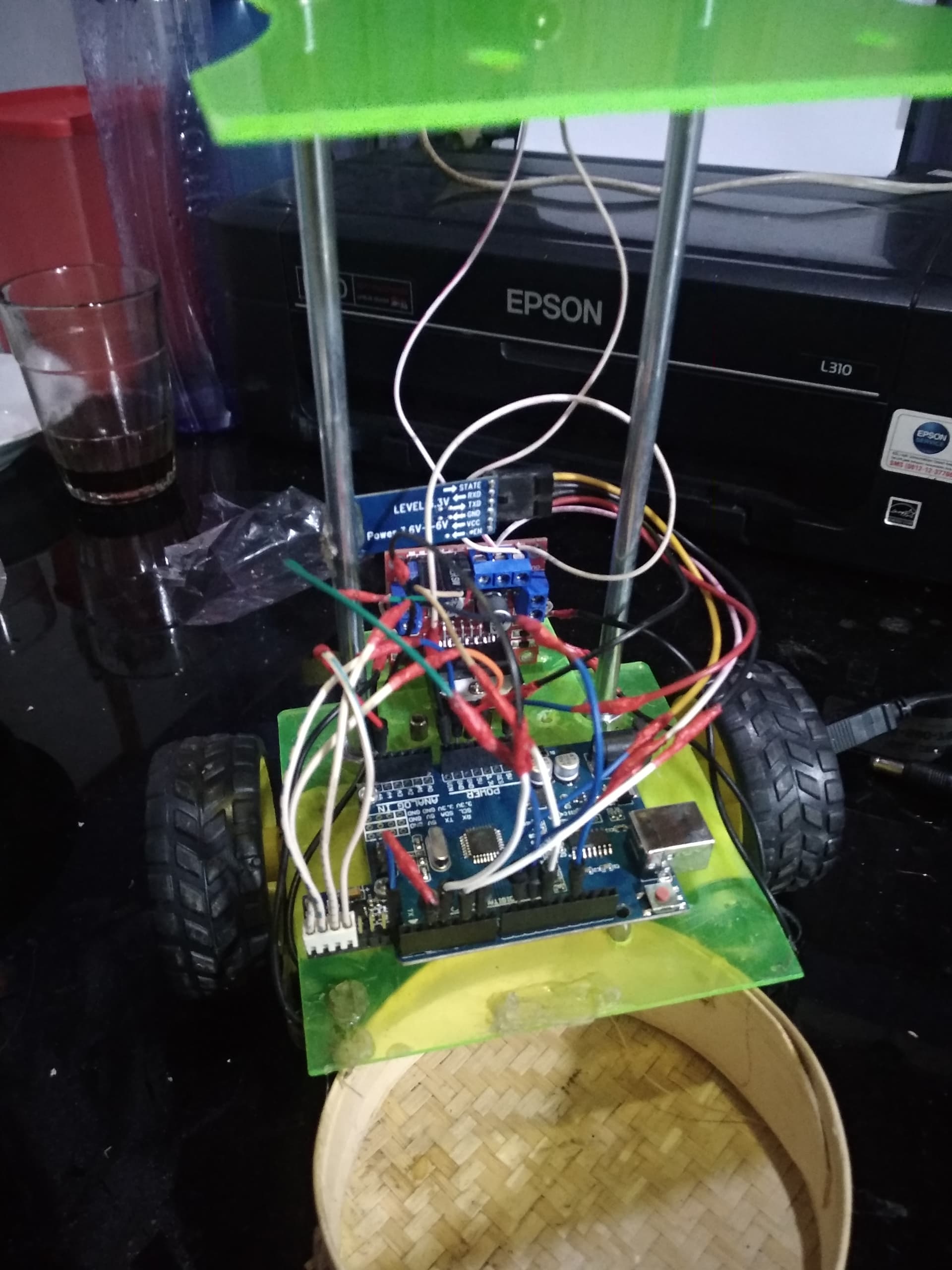

Here's my jimmy. What do you think?
I have reduced the speed and it's already balanced but jitter too fast (even with very small Kd as, 0.014;

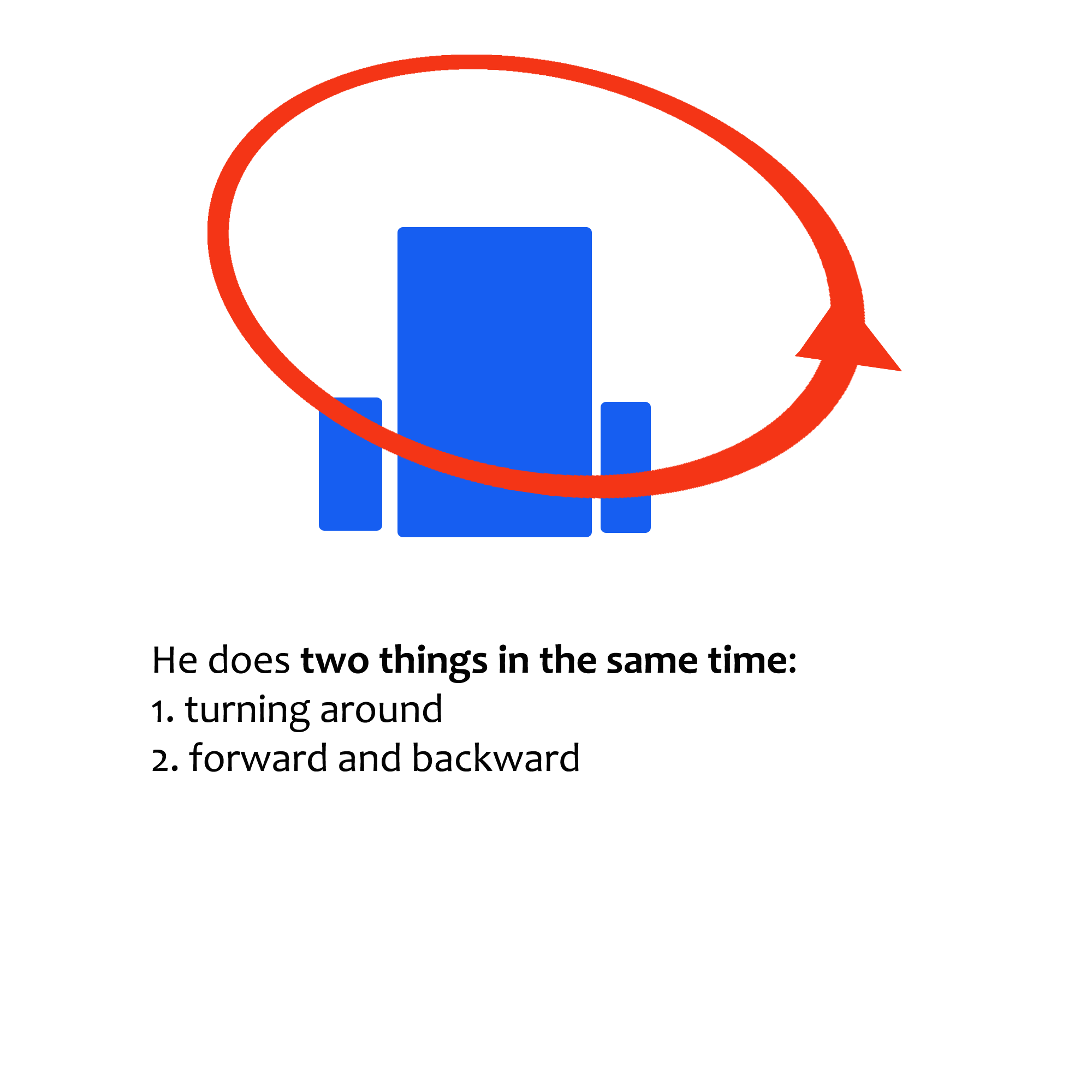

No I mean like this:
  1. both wheels have the same direction when forward and backward. It's balanced enough.
    2., BUT => he turn around (the BODY of the robot turns around and going forward and backward. I don't like to see him like that.
When I make an ONLY self-balancing robot, he didn't like that. When I use bluetooth with that codes, he goes crazy.
Here's the illustration! Sorry for bad pic.
The floor here is 99.999% flat.
