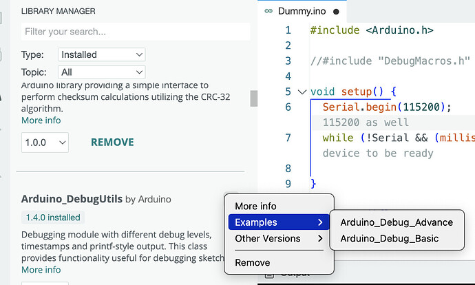

That example is not a part of Arduino, it must be a part of the library that supports it. If it is, you can either locate the library in the library manager then click the 3 dots then samples, OR File/Examples and it will be in the section related to the library.

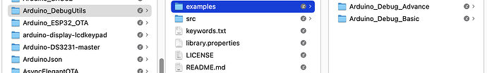

For the actual .ino and any supported files: on Linux, in the shell/terminal
find ~/Arduino/libraries/ -name examples
~/Arduino is your sketchbook; libraries is a sibling directory to each of your sketches. So those are the examples for each Library, with each individual example as a subdirectory.
On Windows, your sketchbook is C:\Users\<username>\Documents\Arduino by default.
Here are 3 ways of seeing the examples
And in your personal libraries
