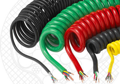

Where can i find a Spiral Cable like this one ?
hello guys,
in my application i need a spiral cable with around 7 or 8 cores like the picture in the attachment file,
i searched on google many sites to buy one but i couldn't find so i would like some help please if you know any website where i can order this from ?
Search for "microphone coiled cable".
Microphone cables do not have 8 cores, this is a specialised cable.
I used to make those myself back in the seventies.
Wrap a piece of cable around a wooden stick, and "(fan)bake" it in the oven for an hour.
You have to experiment with the temp setting.
Has to be just under the melting point of the wire.
Start with ~80C.
Leo..
"Coiled cable" is the relevant search term.
http://specialtywire.com/miniature-cords-pvc-28-gauge-made-to-order-rohs-compliant/
usually ordered as custom assemblies, I think. For relatively small quantities, find a "replacement" cable for some relatively common product. (Hmm. for 8 conductors, see if there are any "coiled cat5 cables." (http://www.cablescience.com/coils/electronic-1/ncc-series.html ) (or maybe serial cables.)

i see around 7
but anyway where can i find a cable like this the same same same :smiley: ?
Click on the picture?
Paul__B:
ha ! nice one :smiley:
alright 16 inches coiled length amazing ! i hope i ca find a supplier in the US to be able to order it via borderlinx.com but before that i am gonna try a shop where he has audio components and electronics
but before that my question is : what are the exact words you typed in ebay to have this results ?
I believe it was "coiled 8 conductor microphone cable".
Found this picture too:
The shield is the eighth conductor. Use it for your ground.
