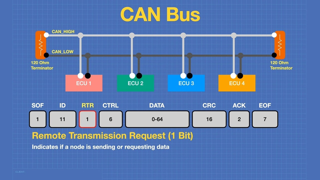

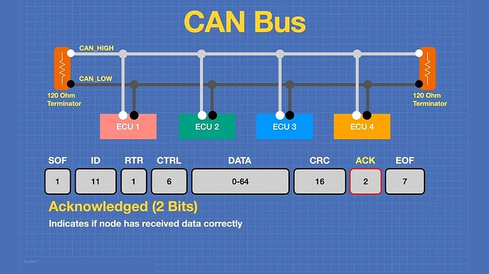

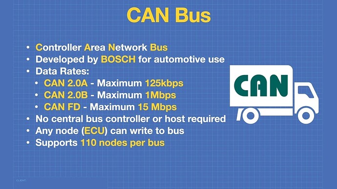

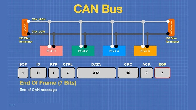

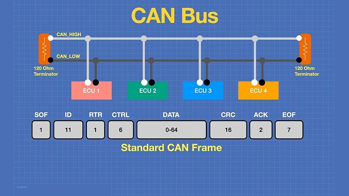

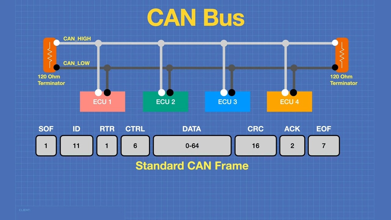

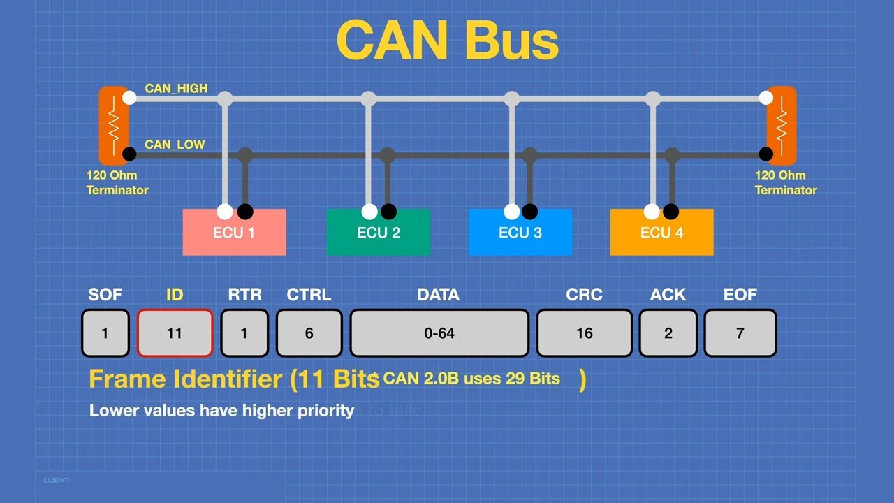

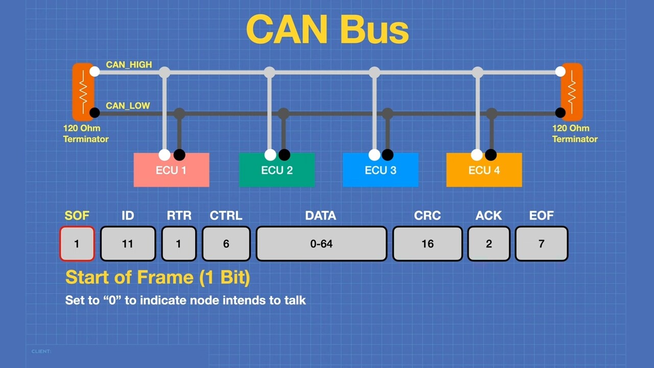

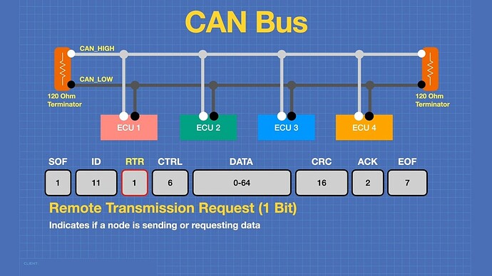

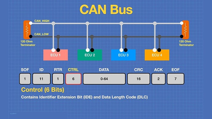

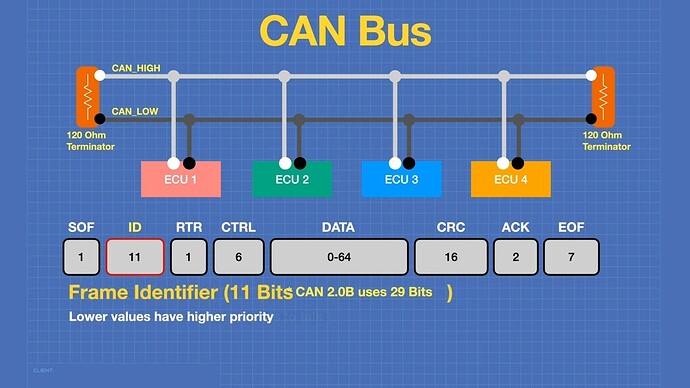

Screenshots from Dronebotworkshop... showing the complexity...
