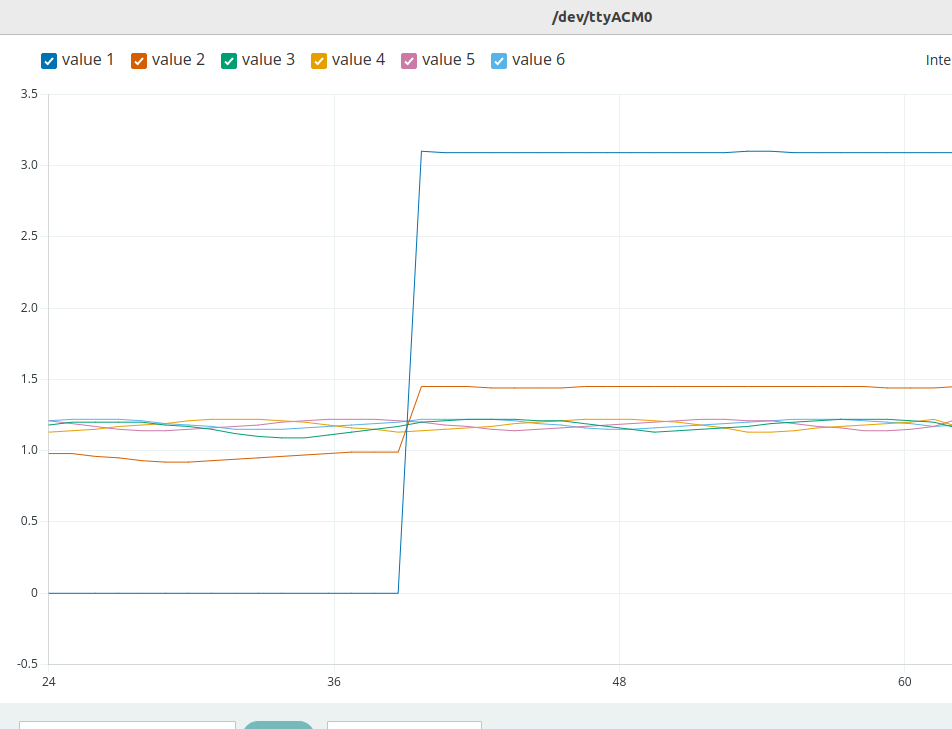

Board:
enter image description here

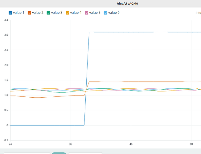

Serial Monitor:
@Delta_G True, they are not connected to any thing now. I want them read 0 since nothing is connected to them.
@Delta_G After your comment, I just connected remaining 5 analog inputs to ground (through a resistor and led). Surprisingly I am seeing a better result that I wanted:
Only one analog is at 3.3 V, which is good. But the remaining pins continue to show around 1 V. Is this normal with arduino?
No but it's normal for what you did.
Try connecting the other inputs directly to ground
@Delta_G @jim-p You guys are amazing. Now the result is amazing. I just connected one analog input to a 5 V, another to a 3.3 V source, remaining four grounded. Here is the result:
