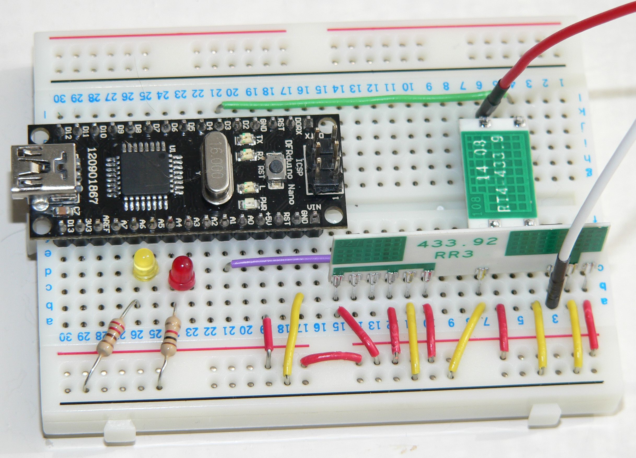

Now this could get controversial, but you may want to work with "breadboards", in which case you want the Arduino Nano rather than the UNO, as this has the same functionality but (is smaller and) mounts directly to a breadboard. Some people will tell you that breadboards are unreliable in the contacts, but in general and with caution, they are a practical way to prototype.
The UNO is not really designed to be used this way - you need more "jumpers" and you have to arrange your breadboard somewhere and perhaps secure it - but it is designed to be used with "shields". If there are shields to perform the interface functions you need, that will be the way to go. And there is no obvious "mini" version of the Mega (or will someone come up with an example?) so you are committed to a separate breadboard and/ or shields.
