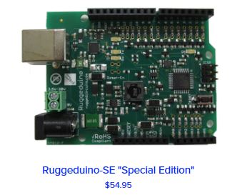

Since it's likely that I could make a mistake and damage the Arduino, I'm considering this board:
It is ruggedized Arduino variant.
The only thing that I see that gives me pause is that it shows that "Total microcontroller current protection" is 150ma. In their demo video on their home page, "5 more ways to destroy an Arduino" it talks about 200ma is the limit for the UNO. Why would theirs protect up to only 150ma? I don't understand the discrepancy.

I would have thought the price might too. The Ruggeduino has the same guts and therefore the same power handling ability as any other Arduino. With a 200ma limit, protecting to 150ma sounds reasonable. Essentially, and as the blurb implies, it is made for idiots who don't know what they are doing or, more particularly, rich idiots who don't know what they are doing. Since it costs ten times more than a standard Uno, you might find that, if you have a crisis of confidence, or are inclined not to read instructions, you could be better off buying two ordinary Unos, and keep the second in the bottom drawer.
You will probably find a use for it later.
Nick_Pyner:
I would more easily believe that it was made for lab use, where hundreds of students would be using or abusing it. I liked two features on it, the crystal clock and increased current on 3.3V.
The product page suggests the student use, engineers who want a more robust product (I would assume that the company is paying for it!) and "anyone who makes mistakes". I don't see the "rich idiots" implication in there. But you are entitled to your opinion. As a learning tool, the Arduino should be expected to encounter "idiots who don't know what they're doing". But I agree somewhat that replacement of a cheap board with another cheap board might be a more economical solution. Also the lesson learned from the failure might be valuable!

Points well taken about buying two standard UNOs for the price of one of these. It has some additional features that the UNO doesn't have. A $55 price point is not that bad.

No, it's ten standard Unos, and the price point is absurd.
It would make sense to me if the product would blow a fuse if the current flow exceeded 200ma, but this implies that it will blow a fuse at 150ma. That wouldn't give me enough capacity on this unit.
If the absolute limit is 200ma, it isn't unreasonable to limit regular use to 150. I believe this is done with a current limiting IC. There are plenty of ways to power things a lot gruntier than a piffling handful of LEDs, people do it all the time, and you just need to learn a bit about how to do it. I imagine it involves no more than using current limiting resistors, which is standard practice.
Nick,
TEN standard UNOs? Where are you seeing that?
On their microcontroller boards page, the Ruggeduino shows it costing $54.95.
On the Arduino Store page, the UNO costs $24.95.
Screen snips attached.
Thanks for the explanation about the 150ma limiting and my piffling handful of LEDs! That makes sense.
Read the ruggeduino product page. It doesn't use anything as brutal as a fuse.
