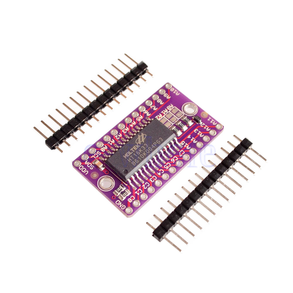

Ht16k33! This chip can drive your displays and your individual LEDs, and also scan your pushbuttons.

PaulRB:
PaulRB thank you so much i'll give it a try ! :smiley:
Found on aliexpress and very cheap !
