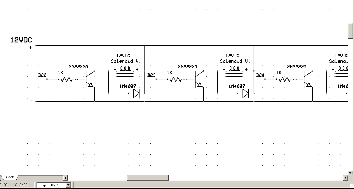

I have 6 x 12V / 350mA solenoid valves.
I will use 1K resistor, 2N2222A transistor and 1N4007 diode.
2N2222A datasheet: NPN Transistors - PNP Transistors
1N4007 datasheet: http://www.diodes.com/datasheets/ds28002.pdf
Do you think my schematic is ok?
Thanks in advance.
At the first glance the circuit seems OK.
Attention to the power supply (6x0,350A = 2,1A) it must be able to provide, at least, 12V and 2,1A.
Ok, thank you luisilva.

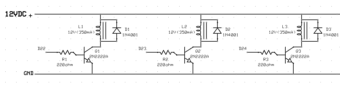

Definitely use a 220 ohm base resistor, 1k is rather too large - see my analysis above
for why.
By the way - a 1N4007 is overkill - not a problem at all if that happens to be the cheapest or most readily available, but since you are using it for a 12V circuit, a 1N4004 (400V) will be just fine. In fact, a 1N4001 (50V) would be just as good but I doubt they even manufacture them any more as inventory is simpler just making 1N4004 and 1N4007.
the 1N4007 isn't really an overkill. It is used as free-wheeling diode and it should protect against the inductive current when switching off the power on the coil. The current that is produced in this moment is much higher then the original source current. Here you can have 100 - 200 V for a very short moment. That's why it is always a good idea to use a 1N4007 for that purpose.

Listen to MarkT, use 220 ohm resistors on the transistor base. Never rely on the small signal gain to determine the base current in a saturated transistor.
I tend to use 1N4007 simply because it is cheaper to buy a huge bag of 1N4007 rather than have a bunch of diodes of different PIV ratings.

Thank you everyone.
This is the final schematic (attached).
(I couldn't find the Ohm symbol in ExpressSCH :slight_smile: )
