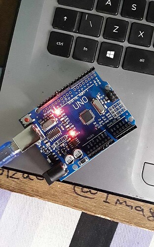

I am a complete newbie in the Arduino world. i bought an Arduino UNO r3 smd edition yesterday, in my first trial I uploaded a code for using servo and it worked, but after that no other code is working, not even the same code that worked yesterday. Blink test doesn't work either, Built-in led lights up but doesn't blink. I have 5-10 different codes, they get verified successfully and even uploads successfully, but doesn't execute.
Here is the most recent one I tried using:

I verified it and uploaded it without any errors, but it isn't working after uploading.

The sketch is ok.
Check wiring and post a picture of the hardware setup.
Apart from the solder joints, it looks good. I hope there were no short circuits. :hushed:
Do a cross check and load the BlinkWithOutDelay example from the IDE onto the pure Arduino.
Thankfully there was no short circuit and I have tried the without blink example after watching a YT tutorial, but that doesn't work either.
(I am not sure if this could be the reason, but the board I am using is a off-brand board.)
There may not have been a short circuit when you checked but with solder joints like this
then there could easily have been in the past
If a short circuit did happen, would it damage the board or the servo?
More likely the board

Let's go back to basics. Try this. Unplug everything except the USB connection to the Uno. Use File/New in the IDE and upload the empty sketch. What happens, what messages do you see in the IDE (post them here), what LEDs, if any, are turned on ?
every time i upload a new sketch the on light and L light lights up, and that's it.
Now try the same thing with the Blink sketch and post the results
Disconnect everything except USB cable from Arduino UNO. Install IDE 1.8.19 and upload the followng sketch to blink the onboard LED (L). Report the result.

The sketch is well compiled, uploaded and run in my 28-pin DIL type MCU mounted Arduino UNO.
The compilation error message reported in post #20 is slowly folding the clue why your UNO board is not working.
If possible, please get an Arduino UNO with 28-pin DIL type MCU (Fig-1) and then it can be said that your UNO is bad. I have encountered many boards with SMD type MCU, which did not work.
