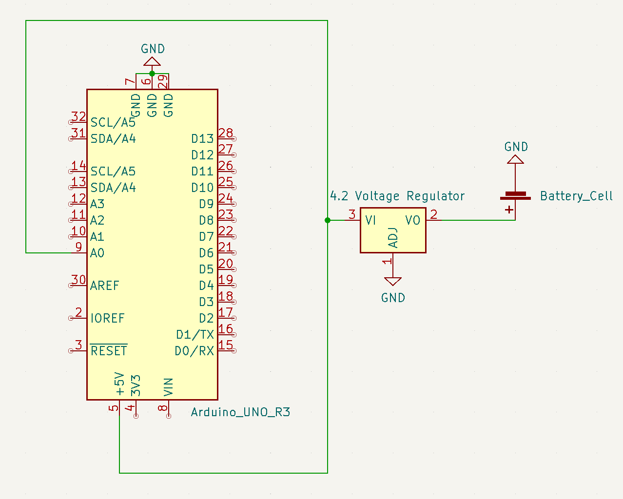

Hello, I am trying to charge a lipo battery. My battery is able to charge at up to 500ma, but it currently is only drawing 0.02A (20ma). Any ideas or solutions will be much appreciated. Thanks for your time.

@TomGeorge, my battery is 500mAh and am using a 4.2 voltage regulator with 500mAh current output.
@killzone_kid, my battery is at 3.6v, I don't think it's almost charged.
Can you please post an image(s) of your setup.
A circuit diagram will be helpful too, just a hand drawn schematic with component labels and pin names will ge good.
What is your power supply for the regulator?
No, that regulator is 1000mA max output.

It would be a much better (and far safer) idea to charge the battery with a device that is actually designed to be a battery charger ............

Fixed!!! Connecting the 4.2v voltage regulator to 5v on the Arduino Uno charges the battery at 4.2v 400mAh. I was trying to turn on and off the charger with the digital IO pin, perhaps I should try to turn on and off the 5v going to the 4.2v voltage regulator with a MOSFET so I can control charging.
This is what I was trying to do before with the digital IO pin:
This is what I am doing now:

well you are lucky Arduino has many pins so once you burn one you can switch to the next and then the next… you are exceeding pin current at least 10x
Edit just noticed second picture, much better, no wonder it didn’t work

If you want to turn of charging because you think you are going to damage battery by overcharging it, you won’t, charged battery takes minimal current and your circuit cannot exceed 4.2v so cant overcharge
