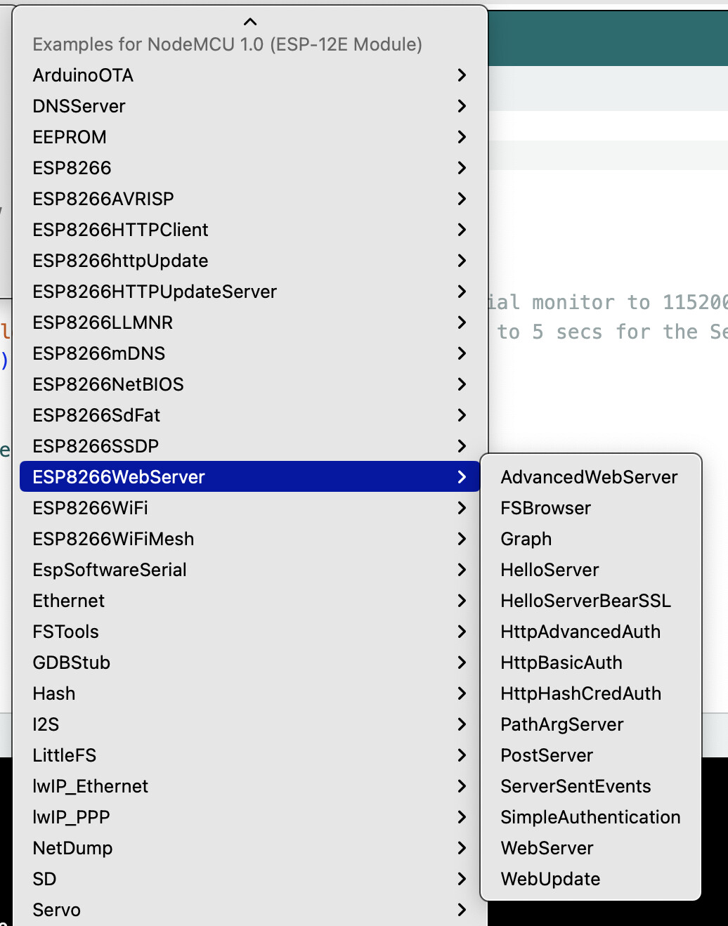

I have ESP8266 boards. I want to send data to the 8266 via my router to tell it to turn on LEDs. what software do I use to communicate with the 8266? I have searched the WEB and can't seem to find a straight answer. Is it C#, C++, Arduino, Telnet, Etc. This is my project, Gather data from my computer Eg. ( LEDSIG1 = on, LEDSIG2 = on, LEDSIG3 = off ) and sent that data to one of my 8266's ( using Mac or IP address ) then the 8266 execute the data, which I have written all ready. What would be the way to do this? P.S. not 8266 to 8622. I need computer via router to 8266. Thanks for your help.
You need to create a web server on the esp8266. There are 14 to choose from, the 'WebServer' is probably the best for you. Then simply design a message protocol that the PC will send to the server and the server will then act upon the msg.
