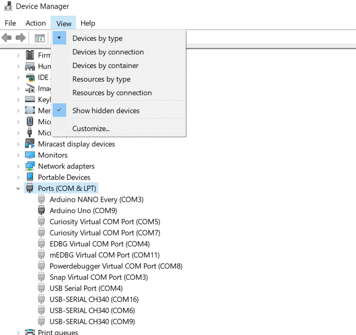

Huzzah aside, i am getting the error I got before which led me to delete the board from the device manager in the first place. I turned on verbose compile and upload messages and have the following error:
Have you checked for failed or greyed-out device installations using COM3 in device manager? Turn on "show hidden devices" Then delete (uninstall) any greyed out COM3 device(s).
