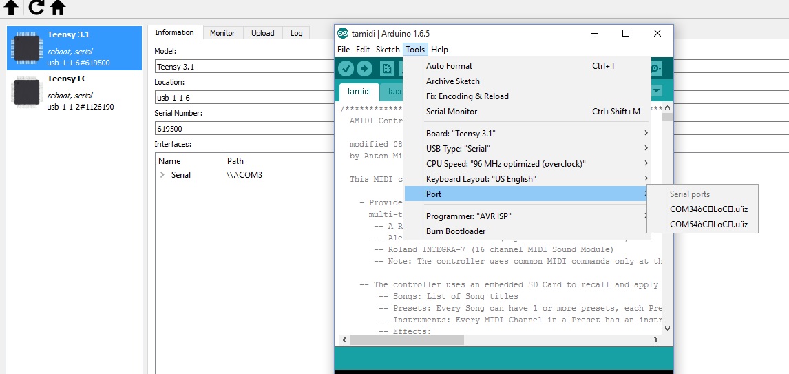

I upgraded to Windows 10 in the last week.
Before this, I had no issues addressing a COM port in the Arduino IDE. After the upgrade the IDE reports a 'no serial port name defined' whenever I select the Serial Monitor. In the COM port selection, as well as the status bar I see COM11 followed by 10 or more garbage characters.
I use Teensy 3.1 and LC's in my solution.
Any help that can be provided would be appreciated.

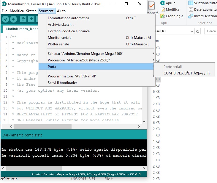

Same problem.. I have Windows 10 and Arduino Ide 1.6.5 r5. The name com is corrupted.
When i change name serial from windows Arduino read name perfect, when i try download fw the name result corrupted and not download FW width error "com%%"!"%£!$%"£ NOT exist....
Width 1.6.6 Hourly Build 08/09/2015 same problem....
