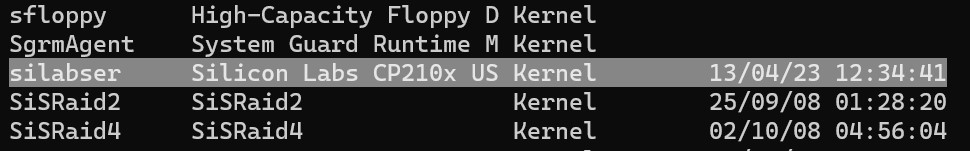

My Windows 11 - Device Manager does not show my ESP32 with CP2102.
However on cmd, I got this:
I have tried to manually install several drivers from https://www.silabs.com/ but nothing seems to work.

Hi @xolo. Make sure the USB cable is completely plugged into both the ESP32 board and the PC.
If that doesn't help, you may have a damaged/defective or charge-only USB cable. Try a different cable.
Either of the above can result in the power connections being made (and thus LEDs lit on the board), but no data connections (and thus no port for the board).
Hi ptillisch,
Thank you for your answer. I have tried everything I could find in the internet and it still doesn't work. I also have the same problem with my ESP8266/CP2102. I have several boards of ESP8266 and ESP32 with CP2102 and all of them do not work with my Windows 11.
I now have ESP32 with CH9102x and this one works well. I use the same USB cable. So the problem with CP2102 and my Windows 11 is now still a mystery. I also have tried the legacy driver of CP2102 without luck.

I can see from the screenshot you shared above that you were already using Device Manager for troubleshooting, but it is worth trying this specific procedure to see whether Device Manager is recognizing any device at all for your board.
Even with no driver or a bad driver installed, you should always see some device appear after plugging in the board. If no device appears, this indicates the problem is at the hardware level (e.g., the board is physically damaged). This is the reason why I targeted the USB cable, since that is a common hardware level problem (though not the only possible problem) which is easily resolved.
Use 'Custom USB Driver installation Wizard' tool change CP2102 PID to 'EA60' and change the VID to '10C4', install CP2102 driver again.

I struggled with this problem. My USB cable is a charge only cable. Try a USB cable that also does data. Every USB chargeable device you buy comes with a charge only cable. I have 20 charge only cables in my house, and only two data cables. I suspect most people are in this same situation.
