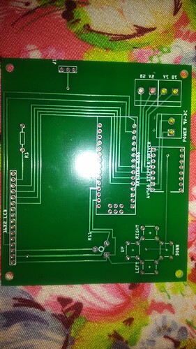

This IS code (credit DIY Arduino based Automatic wire cutting Machine - YouTube and Arduino automated wire cutter - YouTube) I had complete my Project but Servo Motor Not working.

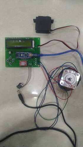

Can you please provide a link to the board that the Arduino is plugged into ?
How is the system powered ?
Does the example servo Sweep program work ?
thanks, Dear for a reply.
yes, example servo Sweep program is work.
check link below.
Powered By 9v - 2Am dc adapter and also try 12v - 2v dc adapter.

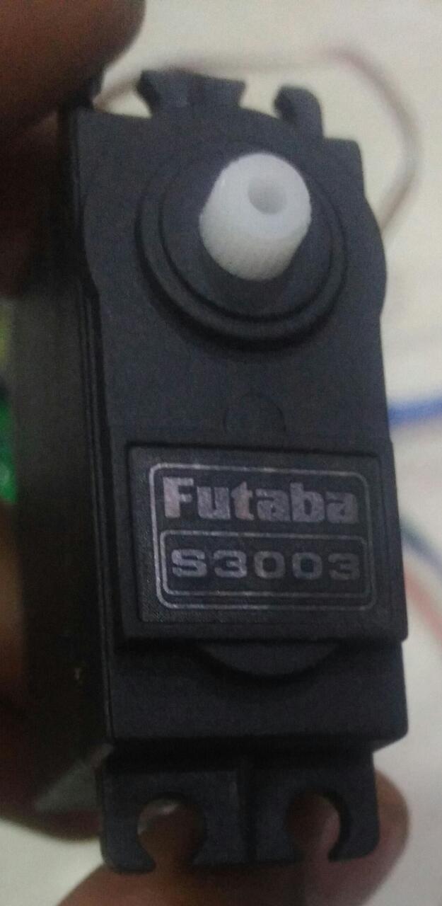

Component:
  1. Nama 17 stepper Motor
  2. Servo Futaba S3003
  3. Arduino Nano

As I asked before. How is the system powered ?
PCB
Have you got a diagram of the circuit ?
Yes, And the pcb circuit board is ready. Please prefer image in my first post.

Sorry, but I cannot find a circuit diagram anywhere in this thread. The pictures attached to post #1 are not circuit diagrams
Please check Google drive link which one I have already share. (Post #5)
You can find also in post #8

None of them are circuit diagrams. At the best they are pictures of the PCB
Sorry for that I don't Have circuit diagram. Just this.

... is at least a block diagram, but it doesn't show the detail. I think what others are wanting to see is how the servo is powered.
That is pretty useless in understanding the circuit
Back to basics.
Does the servo do anything when you power up the circuit ?
If you turn the servo by hand with the power off does it move to the open position when you apply power ?
How is the circuit powered ?
You say that the Sweep example works. Was that with the servo connected to this board or connected directly to the Arduino ?
If you are trying to power a standard Futaba S3003 servo with any load on it from the Arduino Nano's 5V pin then that's why it won't work and you may damage the Arduino.
If you are trying to power a standard Futaba S3003 servo from a 9V or 12V power supply then that also won't work and you have probably killed the servo.
Steve

If you mean that you can move the servo by hand whether or not power is supplied to the system then it means that the servo is not receiving any power.
A: servo 1 wire connect with power supply amd 2 wire connect with arduino.
So not with the servo plugged into this board then ?
