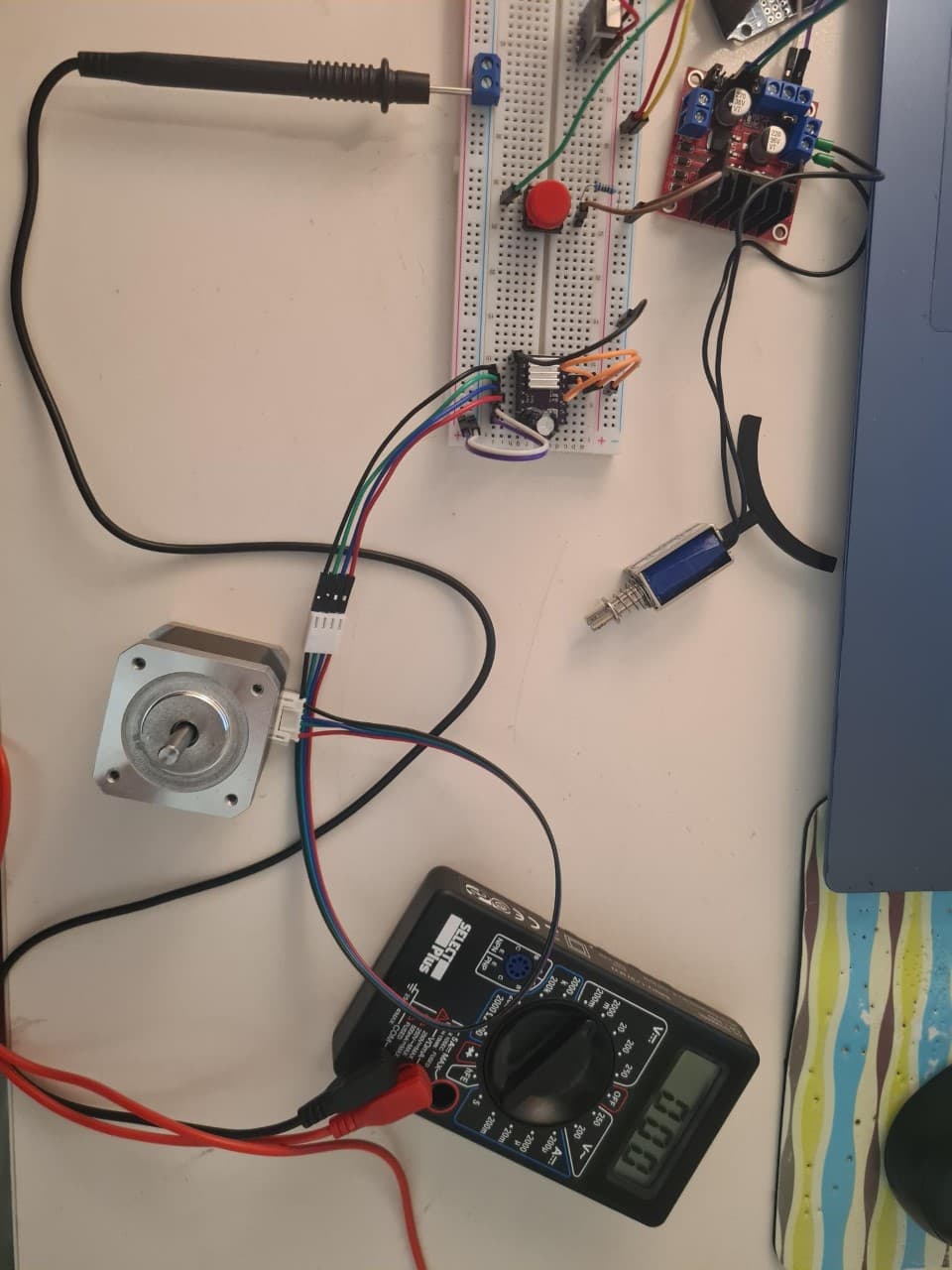

Hello
I'm currently trying to adjust the current limit for my NEMA17 steppermotor but I can't measure anything. I'm sure that I connected everything correctly, but my device still doesn't measure anything. I'm using a steppermotor with a nominal current of 2,5 A, but I have a 12 V 2 A adapter, perhaps this is the issue, not to mention that I also have a setup connected to the same adapter that als draw not much but some power like mini servo's Arduino etc. Could someone help me out?

What are you measuring?
You almost certainly don't need to run the stepper at 2.5 amps! I'd suggest you try 1 amp and see how it goes. Look at the video on the pololu site in the 8825 sectio for instructions on setting the current. You can have the motor disconnected to set the voltage, don't connect or disconnect while powered up though. Also watch the video to the end where it explains why the supply current is significantly less than the motor current you set.

I'm measuring the trimmer and GND for the Vref.
Obviously in this picture the red wire is not connected to the trimmer because I don't have crocodile connectors, but it still doesn't measure the V ref if it's connected.
Is the motor getting warm? The best place to see the voltage is on the slider on the trimpot. Touch your probe on that, it may actually be set to zero.
No the motor is still cold, the slider of the trimmer is still zero.
Tweak the slider a little clockwise and see if you can see a voltage. Are you sure there is a supply to the driver?
Yes, I'm assuming the driver has burned, because the steppermotor used to make a noise when it was connected and now it doesn't also there is no 12 V voltage between 1A-2A and 1B-2B.
