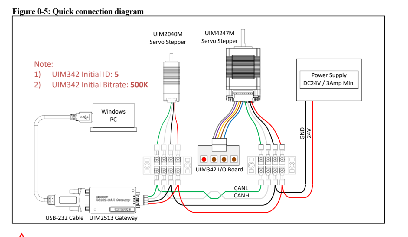

Yes I did read that, but the wiring diagram used a CANBus gateway and I realized I might have to order that. I also didn't understand this diagram:
Mainly, the fact that they only used 4 wires from the servo stepper motor when there are 7.

The diagram shows a combination CAN bus and power distribution scheme. The green and grey wires are the CAN bus, the red and black are power for all devices on the bus. It shows two different motors and the gateway interface to the PC. The MCP2515 module you have replaces the PC gateway. It is a microcontroller gateway.

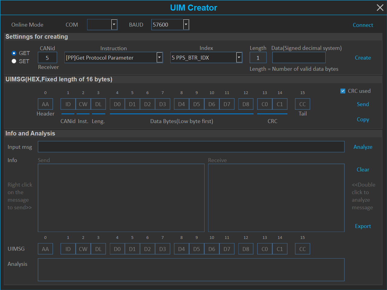

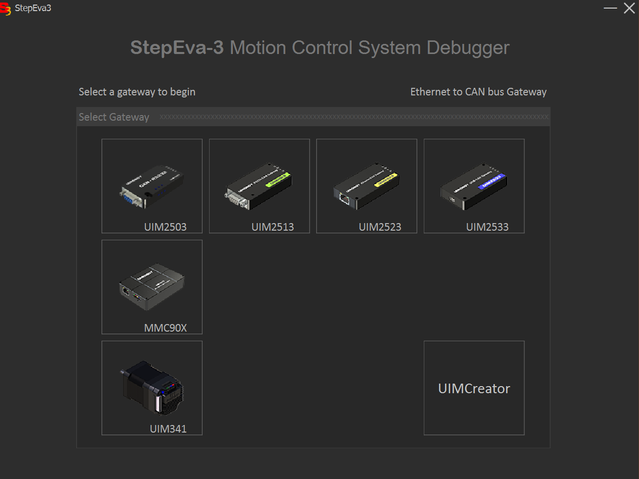

Thanks for your help. So if I want to use a microcontroller gateway such as a Raspberry Pi/Arduino, am I still able to use their software linked here: Stepeva3 Control Panel & Debug Software-Downloads-UNITED INTELLIGENCE ROBOTICS (ZHEJIANG) CO., LTD.- or do I need to use a PC gateway?
I saw on the bottom right it says UIM creator, I'm wondering if I use this to send messages to the Arduino/Raspberry Pi instead of the traditional IDE. It wasn't clear from the manual.
Sorry for all the questions, i'm a complete beginner to this stuff and it's overwhelming.

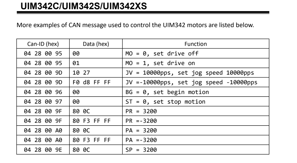

So, I assume you use the UIM creator instead of the traditional IDE to send these messages:
The only issue is if I use the UIM creator how do I know which digital pins to connect the 3 IN wires to on the Raspberry Pi/Arduino? Or rather how do I tell the software this? I don't see an option on the UIM creator interface.
