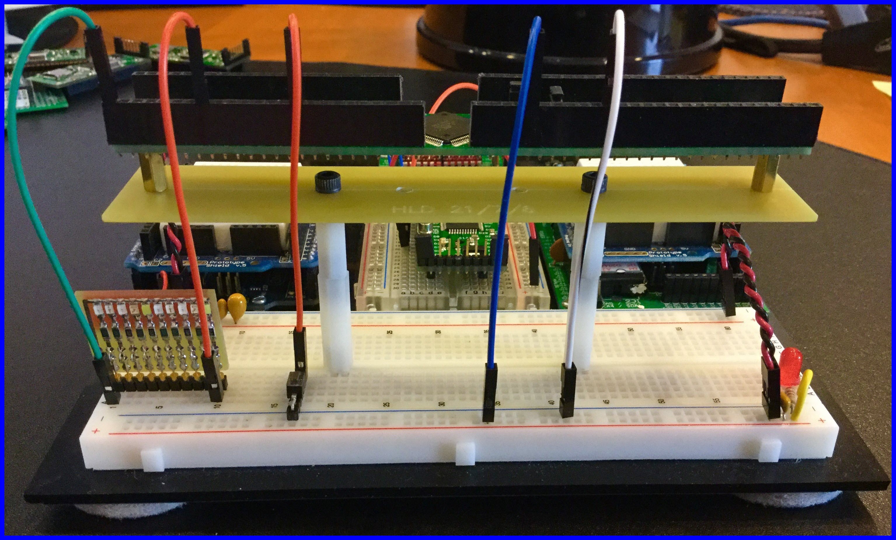

Wooden breadboard -base may rise risks for Arduino and sensors ?
I want to keep my Arduino UNO and 2 separate 800 points plastic breadbords all grouped together.
I know that they are large plastic boards (4 or more conventional 800 points breadbords glued together) but I like to keep apart different segments of the experiments.
For now, I use a rigid plastic cover (A4) covered by a cotton line. Not very stable. And I am concerned about electrostatics.
So, I would like to build a new base, in 12 cm thickness wood, covered by a line of cotton.
Question:
Are they any risks for my Arduino and sensors for this (I addmit - unusual) construct? Electrostatics or conductive problems or whatever?
Thank you for your help!
I think that wood and (pure) cotton are good choices. Neither is conductive or capable of storing much static charge. Well, wood may be a tiny tiny bit conductive, but the resistance would probably be many meg ohms.
12cm thick? Like the width of your hand plus a couple of fingers? That seems like overkill to me. (unless you mean something else for thickness, like left-right width, or top-bottom height).
I have several stuck on a clipboard, with some holes drilled to secure an Arduino to it. The clip is handy for holding ends of wires, and you also stick on additional wire holders.
Only problem is flammability. Make sure your power sources are sufficiently current limited so that an accidental short won't start a fire.

Wood is OK. Where I work, we have rolling wire-metal shelves covered with particle board in our burn-in room. For certain assemblies, we place PC boards flat on the shelves (with the circuit-side in full-contact with the wood) and power them up for a few days of burn-in at elevated temperature. We've been dong that for more than 15 years. (Without the wood insulator, the metal would short-out the boards.)
The wood is not conductive enough to pass ESD testing,* but I've never seen a spark generated by wood and our boards don't die.
And at home, I usually solder on a "disposable" piece of wood.
  • The QA folks who routinely test the ESD mats on our workbenches haven't realized what we are doing in the burn-in room. :smiley: :smiley: :smiley: But, we also have a wood-topped shelf in our production area and that's been tested. It fails and it's got a "Do not place ESD sensitive parts..." sticker on it. Of course we do, because we are an electronics company and most stuff we work on is static sensitive! ...Maybe someday, they'll get around to putting an ESD mat on that shelf.
Unless the OP is using a grounded wrist strap while working on his projects, he is wasting his time. Any plastic, including his breadboards can build up a static charge.
The usual culprit in ESD damage is a person wearing some synthetic clothing, walking across a Nylon carpet and then touching something electronic. See the spark?

Yes, wood is good. We use a wooden platform some times as an arm rest to place or align SMT parts on a circuit board that has been solder pasted. Board can slip under the platform if necessary. The platform sets on an ESD mat.
An ESD wrist strap and connecting wire contains a 1 meg ohm resistor so the wearer can't get shocked. All my people use one when working. They also wear two foot straps to ground them to the concrete floor. Each morning they test both the wrist strap and the foot straps on a testing machine and record the test results.
ESD is cumulative in effect, so every little "zap" may not immediately cause a defect, but may add up over time to cause a failure. We don't want failures!

As a hobby, the electronics part of my shop has none of the commercial stuff I wrote about. Never has, never will. The only ESD piece is a soldering iron that is grounded to the 3rd pin of the outlet. I have never has a problem traced to ESD. Always something else! I would not worry much about ESD at home, if I were you.
If you notice yourself getting shocked from static electricity, then you might take steps to ensure your personal charge is drained off before setting down to work on electronics.
