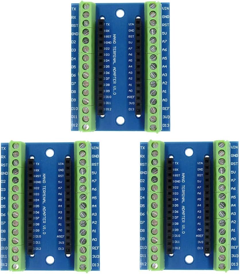

A Nano is the most practical for basic projects. A UNO is only ever useful if you have a "shield" to use with it that fully implements your project. A Nano can be used on a breadboard with pins soldered, or connection soldered to its pads. Actually, very practical to use with a matching "screwshield".
