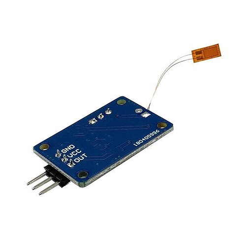

hallo , i'm triyng to use y3 modules to measure flex on axle and other components , bought some of them in different month and supplier and all of them cannot be trimmed at zero tipically locked at 403 and most important no variation when bf350 flex .
wiring so basic that not possible to make mistakes unless some particular trick , is it possible that all of them have issue if so different suppliers and period ?

Supply 5V/GND to your module and connect your multimeter to gnd/output pin to measure voltage. Adjust potentiometer to get 2V output while sensor is flat. Bend the sensor and observe output voltage.
So if you turn the pot all the way from on end to the other the output is stuck at 403?
exact , several turns of the potentiometer and nothing changed or calibrated or at least 8 or 10 modules from 3 or 4 supplier in different month delivery , i think different arduino uno too .

Do the whole verification with multimeter like I posted. Also measure the 5V supply voltage.
test done , 4.95v approx supply and zero in any case to the gnd-output pin when connected to arduino , of course unless there must be some read at arduino .

Connections should be like this:
VCC->5V
GND->GND
OUT-> A0
Please post your code, so we can see if something is wrong.
here is the pin connection , very easy with gnd and supply 5 v and signal pin to a0

Do what I suggested on post#2. If that doesn't output voltage change on your multimeter when bending, you are wasting your time with Arduinos.
Maybe your strain gauge is not bf350?
You can measure resistance of your (disconnected) strain gauge with multimeter, it should be ~350ohm while flat.

applied 5 volt supply to y3 module and measure gnd to out so i was able to measure volts once trimming , result 3,5 fixed and no way to modife even lightly ot trim .
i'm simply bending bf350 , in one of this module disconnected and measure correctly around 350 resistance .( solded a new bf350 too )

You can trace out the connections on the module and draw a schematic. Then you can see if the modules are designed right.

Are you sure about your wiring? Maybe you have pins wrong?
Your image on post#9 doesn't match with this Y3 module:
This would translate on your image:
Red=Gnd, Green=Vcc, Black=Out
