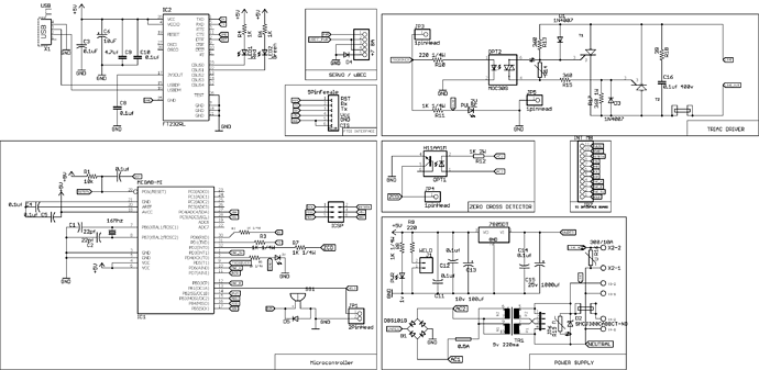

Thanks John. I just verified the pin out from the attached with an uno and they seem to match. I chose the TQFP only because of its bigger size, the QFN/MLF are smaller and the number of leads, 32 are same for both.
