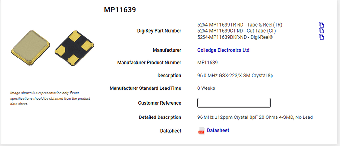

96 != 100

Thanks for trying to help. I trying to build crystal-controlled FM transmitter.

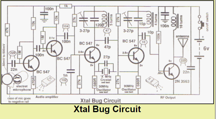

I assume you are wanting to build a "bug".
https://www.talkingelectronics.com/projects/CrystalLockedBug/CrystalLockedBug-1.html
You don't necessarily start with a 100MHz, crystal.
The technology uses frequency doublers and triplers, to get 100MHz carrier.
