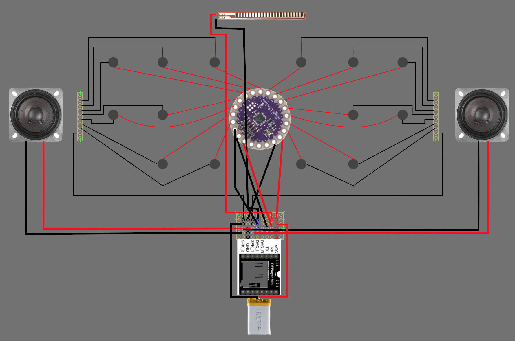

Hi, all
It's jeremy again:)
I've got 14 coin motor project still.
with lilypad arduino, I've got cloth and circuit already.
this is my code

When flex sensor straights, flexVal increases above 4 and goes to 'else'.
Though I put 4 simple lines in coin vibrating parts.
It has 40 long codes about 30 sec.
This is my question, like this way, flexVal doesn't change till coin vibrating parts over.
Can I change this 40 long code to simple code with random function?
and How can I get out this loop right away when flexVal changed?
Sorry for the bad english but I'll awake 24 hours from now
so.. help..
Correct. The Arduino can't do anything else while it is in delay().
Study the "Blink without delay" example that comes with the Arduino IDE to learn how to avoid this.

I'm stuck in
int randomMotorOne = "c + random(1, 15)";
this parts. I know it's wrong cuz that isn't int.
But I don't know how 'randomMotorOne' can give me series of [c1, c3, c14, c11...] randomly :frowning:
int randomMotorOne = "c + random(1, 15)"; Quote marks identify a string constant (character array). Remove them.
