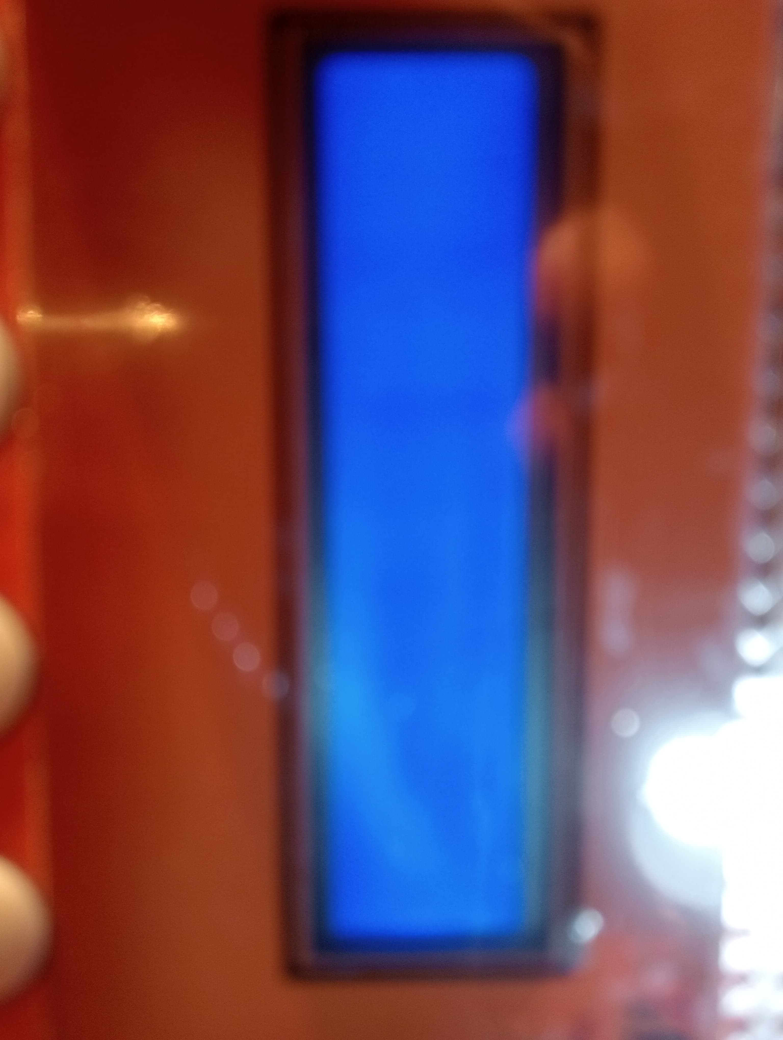

Hello, I made an application with arduino nano and 1602A lcd. When I energize for the first time, everything is normal, after a few minutes, my contrast decreases and nothing can be seen on the LCD. I re-adjust the adjusted resistor connected to Pin3, but after a while the same result again. Meanwhile, the 5v and 3.3v voltages do not change at all. The voltage at pin 3 increases from 0.7 volts to 2.5 volts in amplitude. Tried the 3 connectio

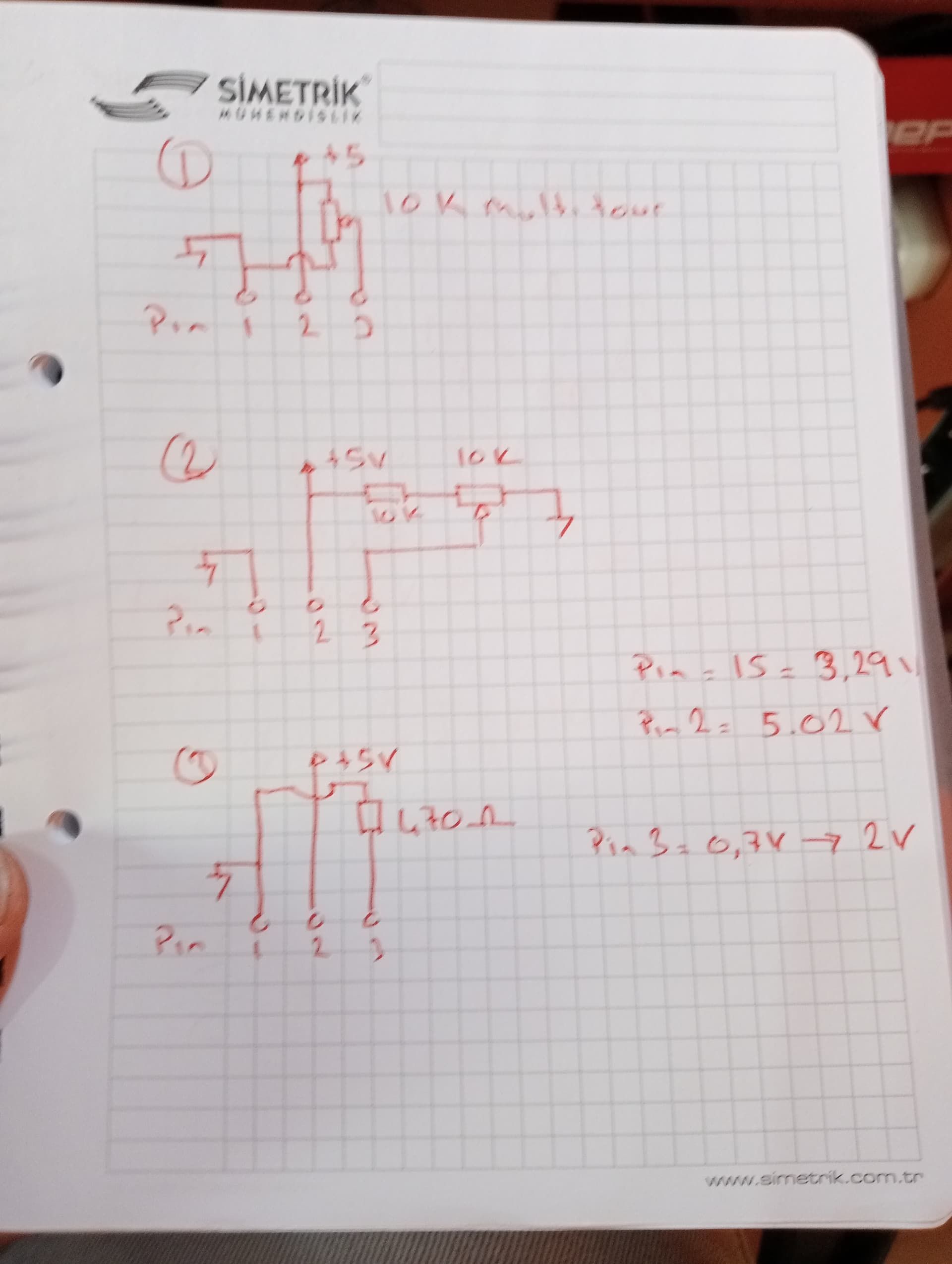

ns shown in the picture, the result is the same. If I connect pin 3 to gnd, the contrast increases a lot. It's been 3 days. I've been struggling, I reinstalled it over and over with 4 different lcds and arduino, the result is the same.
The schematic labeled 1 is correct, although the LCDs I've used recently work fine if pin 3 is simply grounded.

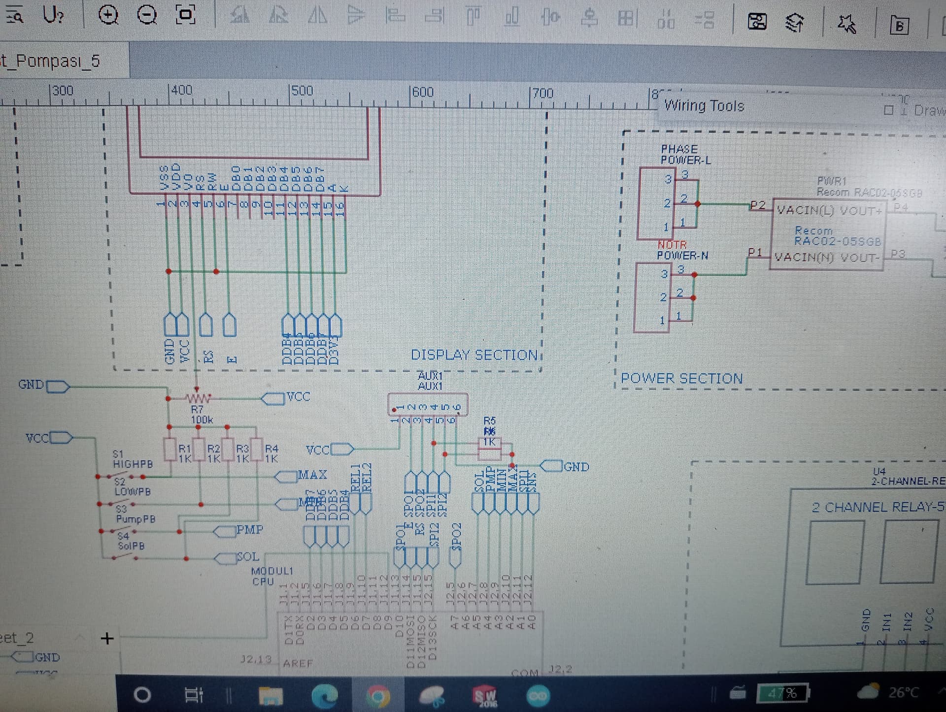

Something else is wrong. Please post a complete schematic, showing ALL the connections.
The photo has the original scheme. When the problem came up, I tried the solutions I wrote earlier. The result is the same. When I watch Pin 3 on the oscilloscope, I occasionally see square wave signals,
Sorry, the partial photo of the system schematic is useless, except to show R7 incorrectly specified as 100K.
Check for wiring errors, solder blobs or poor solder connections.

Well, actually, it isn't. The potentiometer should not be connected to 5 V at all. The schematic labelled 3 shows you a resistor to ground which is correct but you may wish to vary the resistance, so a potentiometer wired as a plain variable resistor is what is required. The appropriate value is actually 1k, but if you only have a 10k resistor, you can make it more usable by connecting both ends to ground (thus halving its effective value) and the wiper to pin 3.
This of course, does not address the fading problem which is due to the power supply collapsing. This is almost certainly due to foolishly attempting to power a UNO or Nano by the "barrel jack" or "Vin". You need to provide a proper regulated 5 V to the "5V" pin as well as the relay module and any other attachments. If using a UNO however, you need to disconnect the "5V" pin while you plug the USB into a PC.

The wiring-diagram / schematic in #3 is a bit suspect. We don't see the "POWER" or "RELAY" sections.
I doubt if the Uno regulator would have a problem with the 2mA consumed by a HD44780 or even the 20mA from some backlights.
But relays, power, active-high switches are very suspicious. More likely to make VCC collapse rather than go "above" 5V.
"Multiple" external power sources seem unwise.
